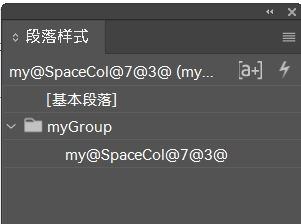

Aug 04, 2025 Aug 04, 2025
This makes a group and returns a Pstyle if they do not exist, or returns the existing Pstyle if it does
var ps = addParaStyleGroup(app.activeDocument,"myGroup","my@SpaceCol@7@3@")
$.writeln(ps.name)
//returns the style’s name my@SpaceCol@7@3@
* Returns a ParagraphStyle named sn in a group named g
* @ param the document to add the group and style
* @ param the paragraphStyle group name
* @ param the paragraphStyle name
* @ returns the paragraph style named sn
function addParaStyleGroup(d,g,sn){
    //check if group exists if not make a group named g
    if (d.paragraphStyleGroups.itemByName(g).isValid) {
        g = d.paragraphStyleGroups.itemByName(g);
    } else {
        g =  d.paragraphStyleGroups.add({name:g});
    //check if a p style named sn exists if not make
    if (g.paragraphStyles.itemByName(sn).isValid) {
        return g.paragraphStyles.itemByName(sn);
    } else {
        return g.paragraphStyles.add({name:sn})
