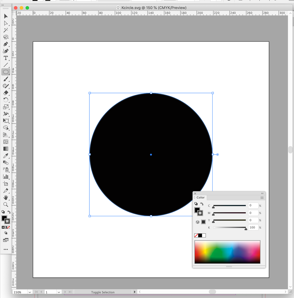

Hi Laura, As Uwe suggests you can save a CMYK mode Illustrator document as SVG but the color fills get converted to RGB on the save. SVGs also do not include color profiles, which could create additional color problems when they do have to be converted to CMYK. It might be worth placing your SVGs on an InDesign page, Export the page to PDF/X-4, and use Acrobat’s Output Preview>Object Inspector to inspect the SVG object.
Here’s what happens to a CMYK 0|0|0|100 fill:
Saved SVG placed—InDesign’s Separation Preview shows the black fill will convert into 4-color when the export or print is to Document CMYK:
The page exported to default PDF/X-4—No Color Conversion. Object Inspector shows the fill as RGB with the InDesign RGB profile embedded:

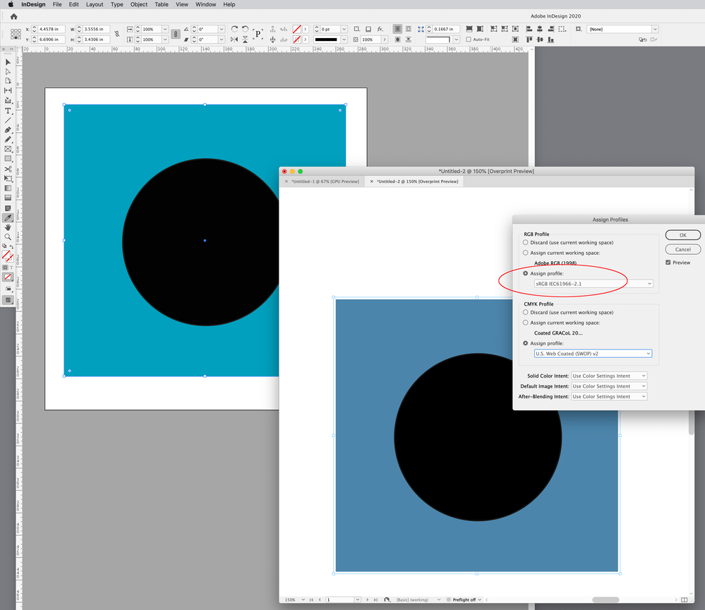

Hi Brad @ Roaring Mouse , It looks to me like the color in an Illustrator CMYK document gets converted to the Illustrator Color Settings’ RGB Working Space on an SVG export and the profile is not included, so I don’t think we can assume sRGB would be the correct profile. The SVG with no profile gets paced into InDesign as DeviceRGB, so its original color appearance would change depending on the ID document’s RGB assignment.
Here I’ve made an illustrator CMYK 100|0|20|0 fill. The document’s CMYK profile is default USWeb Coated SWOP, and the current Illustrator RGB Working Space is ProPhoto RGB:
If I Export and place the SVG in an InDesign doc with sRGB as the assigned RGB profile, I see that the color appearance in InDesign doesn’t remotely resemble the original Illustrator CMYK appearance:
I can get a match if I set the ID RGB assignment to match Illustrator’s ProPhoto RGB Working Space, but it would be difficult to stay on top of the RGB assignments and working spaces with an RGB only format that doesn’t allow profile embedding:
