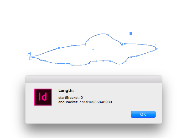

My suggestion would be to add a text path to the shape. Add some text, eg. "a b c", set it's formatting to fully justified and read out the values for startBracket and endBracket:
// Arbitrary shape selected.
// Add text path to selection:
var textPath = app.selection[0].textPaths.add();
// Add text with at least two blanks to the text path:
textPath.texts[0].contents = "a b c";
// Set the formatting of the text to fully justified:
textPath.texts[0].justification = Justification.FULLY_JUSTIFIED;
// The endBracket statement should show the length of the path in points:
alert
    "Length:"+"\r"+
    "startBracket:"+" "+textPath.startBracket +"\r"+
    "endBracket:"+" "+textPath.endBracket
Screenshot of the result:
Details of startBracket and endBracket:
