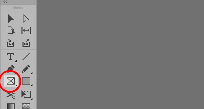

Hope you could help me 🙂 I have just installed the latest version of Adobe indesign and I would like to chain my text between 2 blocks of text. I looked on youtube the way to do it but I don't have the little square on the block of text that allows me to do it.
Here is a screenshot of my screen and the text block !
I'm stuck on this, thanks for your help if you know :))

You need to create the frames with the Text (T) tool. You have created those frames with the Rectangular Frame Tool
Only the Type tool creates text frames that can be threaded together.

There are several problems with your approach.
You are on the parent page. You are working with rectangular frames instead of text frames.
Can you please show a screenshot of the "New Document Dialogue"? Are primary text frames active or not?

Tip for the future:
Right-click on a selected frame that was accidentally created with the wrong tool --> then: "Content" gives you the option to change the type of frame.

You have first create a text frame. Once you create your first text frame (which in your screen capture, it seems you've instead created empty frames with the Rectangle frame tool, which makes what you want to do more complex), you will be able to thread text between multiple frames.
Try this:
  1. Delete the empty frames on your document
  2. Get your Text tool
  3. Move your Text cursor to the upper-left corner and click-drag a text frame that fills the left side of the page
  4. When you do that, you'll see that little square (the exit point) that you're looking for
  5. Click on it, then move to the upper-left corner and click-drag a text frame across the right-hand page
There are many more elaborate ways to do this, which you'll doubtlessly see here shortly. But this is the simplest way to create and link text frames, and get the results you want.

For future reference you can right-click any frame and select Content to cahnge the frame type.
