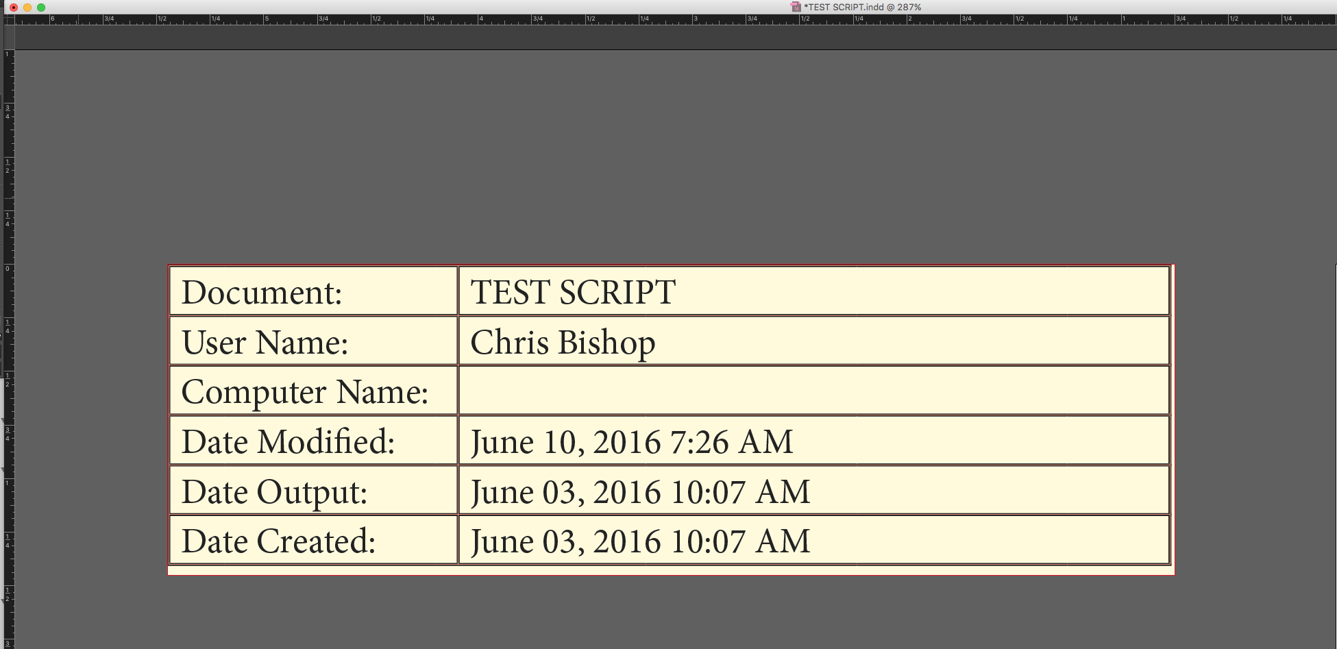

I probably didnt explain it well.  I'll post pics.  And it turns out that its not just mm its all sizes except for the Inches sizes that mess up The small bar is what shows up on everything except for the inches.
Inches
MM and every other Measurement setting.

Ok i figured out what was causing this Problem.  I had a part of the script that Adjusted columns to be different sizes.  I had the size set on it but forgot to add the.  WHere the myWidths [] is i had it set to var myWidths=[1.35, 3.32]; I did not have the "in" after the size.  Adding the inches *in*after the Size fixed the problem below is the Code that fixed my problem.
