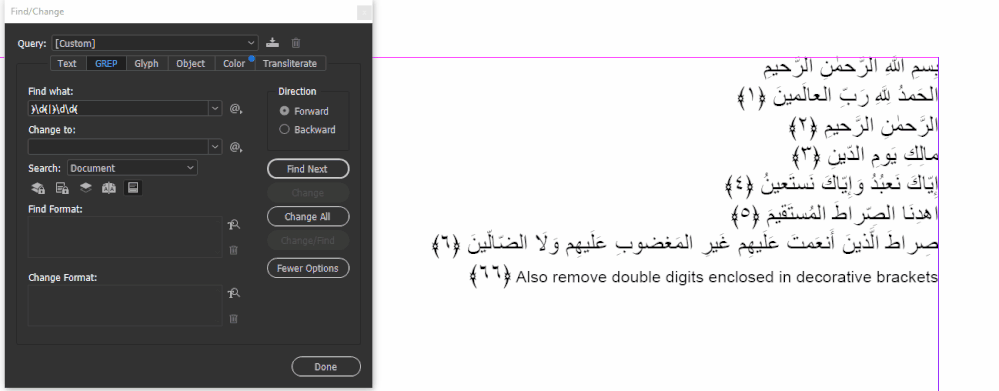

Anyhow, I'm looking at your sample screenshot, and I'm seeing a few things that confuse me. The character drops (the pink rectangles) are there because you're using Adobe Arabic here, and it doesn't have an end of ayah glyph, yes? Also, the first line doesn't have an end of ayah because it's actually the bismillah, right? I'm asking because we'd need some kind of segmentation to chop up your target document, and end of ayah is something I've used myself to that end, in the past.
Lastly, here's the GREP Style technique that I think would crash your computer. It works fine for a few searches, probably not so well for thousands.

@Joel Cherney
First of all, thanks so much for the effort.
Yes you are right. I want a script to flag out the lines which mismatches from the database.
In the screenshot you will see 2 character drops which are showing in pink. Those are the opening and closing Arabic brackets. In some lines you will see that there is only one char drop. That is a special character.
Currently, I just want the line till first opening bracket(excluding the bracket) to be read and then compare it with database. If it mismatches, apply a character style flagging that something is wrong in this line. If the compare result it ok, it will match the second line.
I may include the bracketed matter for comparision in future, but at present, I would like to do it without them.

When I run the script, it is giving the message "Compasred with master content, 2 different paragraphs were found".
I dont know why this is happening.
What needs to be done now ? Is it the new line char or something else ?
Regards
Enthusiast ,
Feb 27, 2023 Feb 27, 2023
@m1b  Thanks so much m1b, it works. It was my mistake.
In the database, matter was in lower case and in text frame, it was in Upper and lower case.
I changed the case and it worked. Thanks a lot.
I will try to implement this login in Quran comparing.
