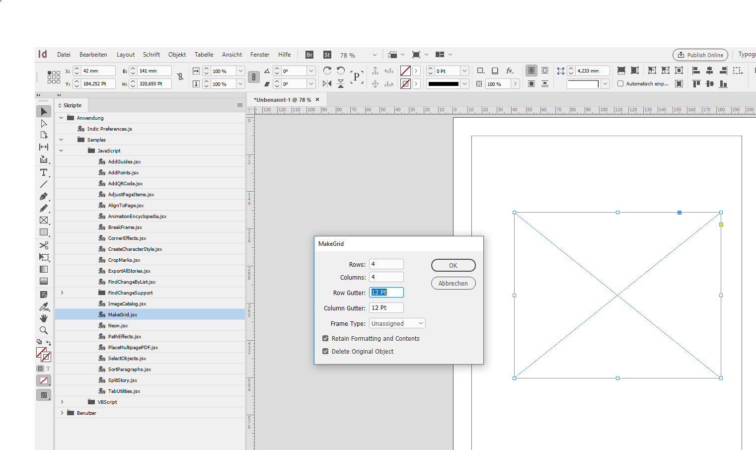

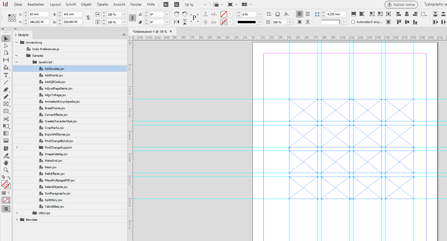

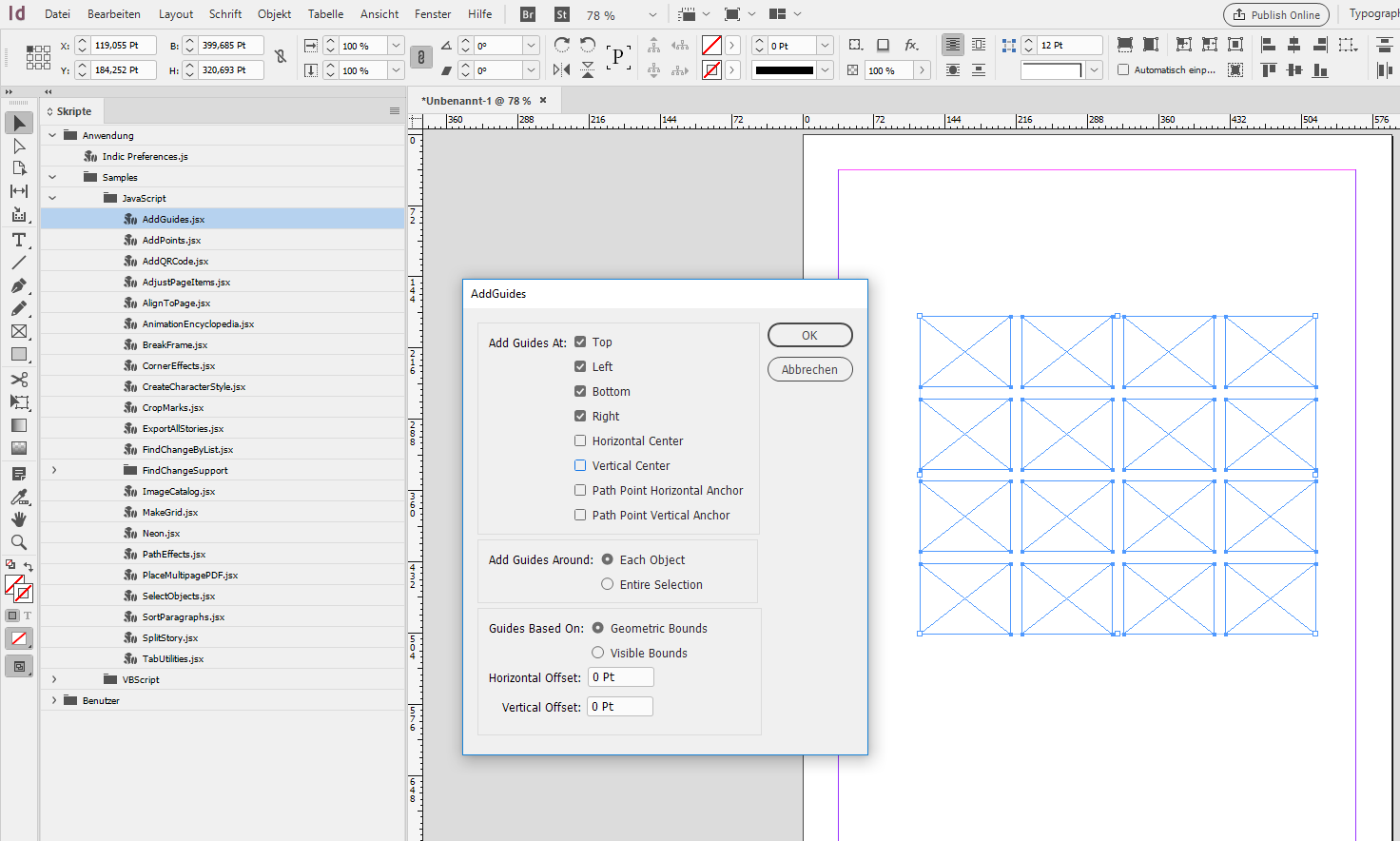

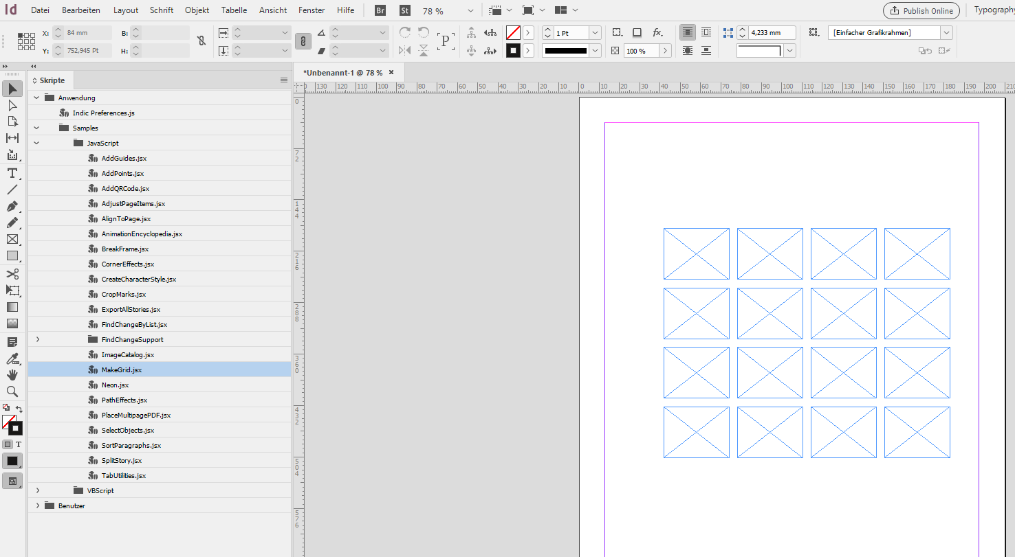

If you want a grid of guides out of your rectangle, then I suggest a two-step process:
1. Use the MakeGrid.jsx script that you can access in your Scripts panel:
2. Then use the AddGuides.jsx script:
Finally remove the objects that MakeGrid.jsx has done.
Uwe

Is this what you're trying to achieve?

vinny38 Yeah! Exactly (sorry for the delay in coming back).
