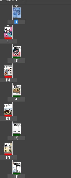

I was having a  hard time understanding the terminology everyone was using since I didn't go to any in person classes for this. I called adobe support and it took them sharing screen with me and answering a lot of what I imagine to be baby talk to start to understand what the problem and questions I was asking. The printer needed a not facing pages delivered, but then that messed up the master pages I had applied and how I would design within the bleeds (which would mess up when I was designing in facing pages mode), the trick was to turn Allow Document Pages to Shuffle off and do in this layout

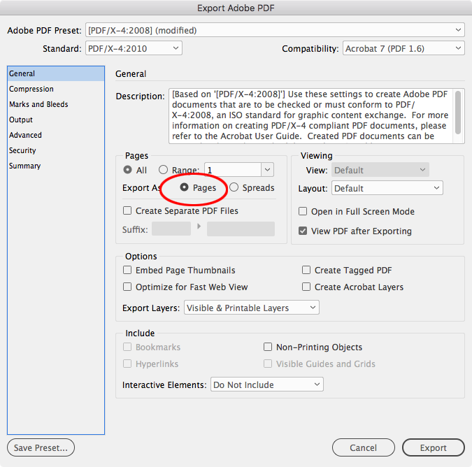

You are misunderstanding the printer‘s request. When you export to PDF you have a choice of Spreads or Pages in the Export>General tab. Choosing Pages exports single pages whether the document is setup as facing pages or not. Acrobat lets you view pages as Two-up Facing, but they are still single pages :

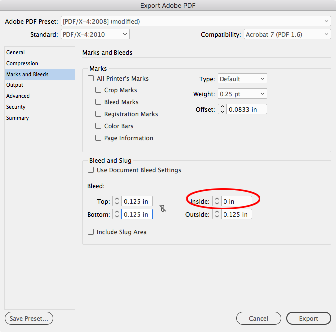

And you don’t need to split your facing page spreads apart for magazine binding, just set the inside bleed to 0 as Bob suggests. You can do that in the document setup, or in the Marks and Bleeds tab. here I'm overriding the Document Setup:

The master pages reflect on the Left and Right of the pages with the page markers. So working with single page environment while designing would be extremely hard. Its a sponsorship magazine so we are adding new sponsorships and arranging pages to what the businesses payed for.

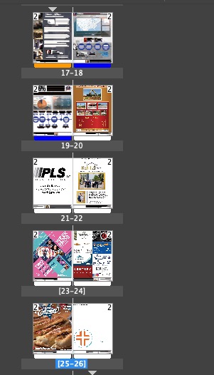

No. I need to design in a two page layout next to each-other both the footer page numbers to be designed.
But when moving pages, I constantly have to adjust the bleed on the pages.

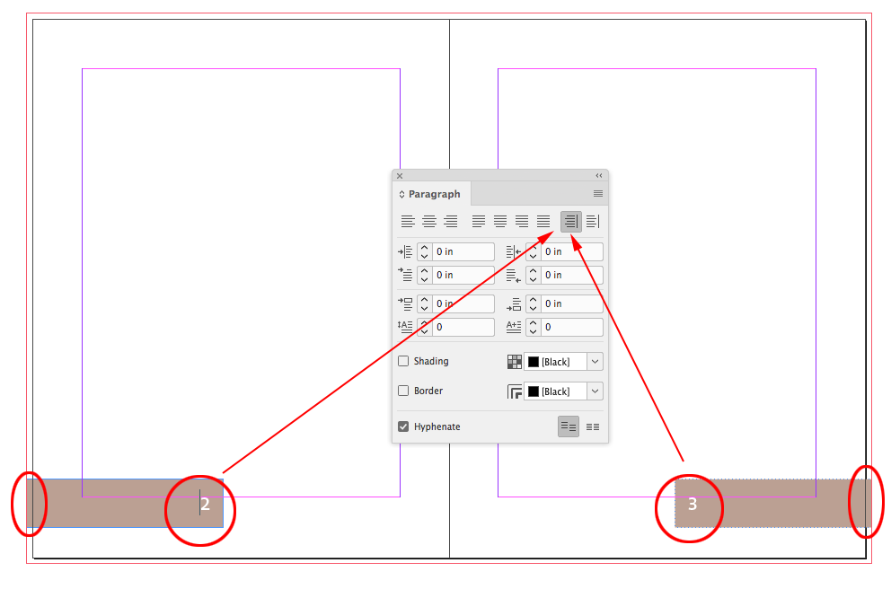

So you are not trying to impose, you are just changing the layout design? The defined page bleeds wouldn’t change when you reorder pages, but if you are trying to maintain the page number position there's the Align to Spine paragraph justification setting.
Here I have the page numbers set to Align Towards Spine, with their container frames bleeding. If I where to change the order of these pages the folios would not change position:

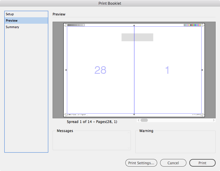

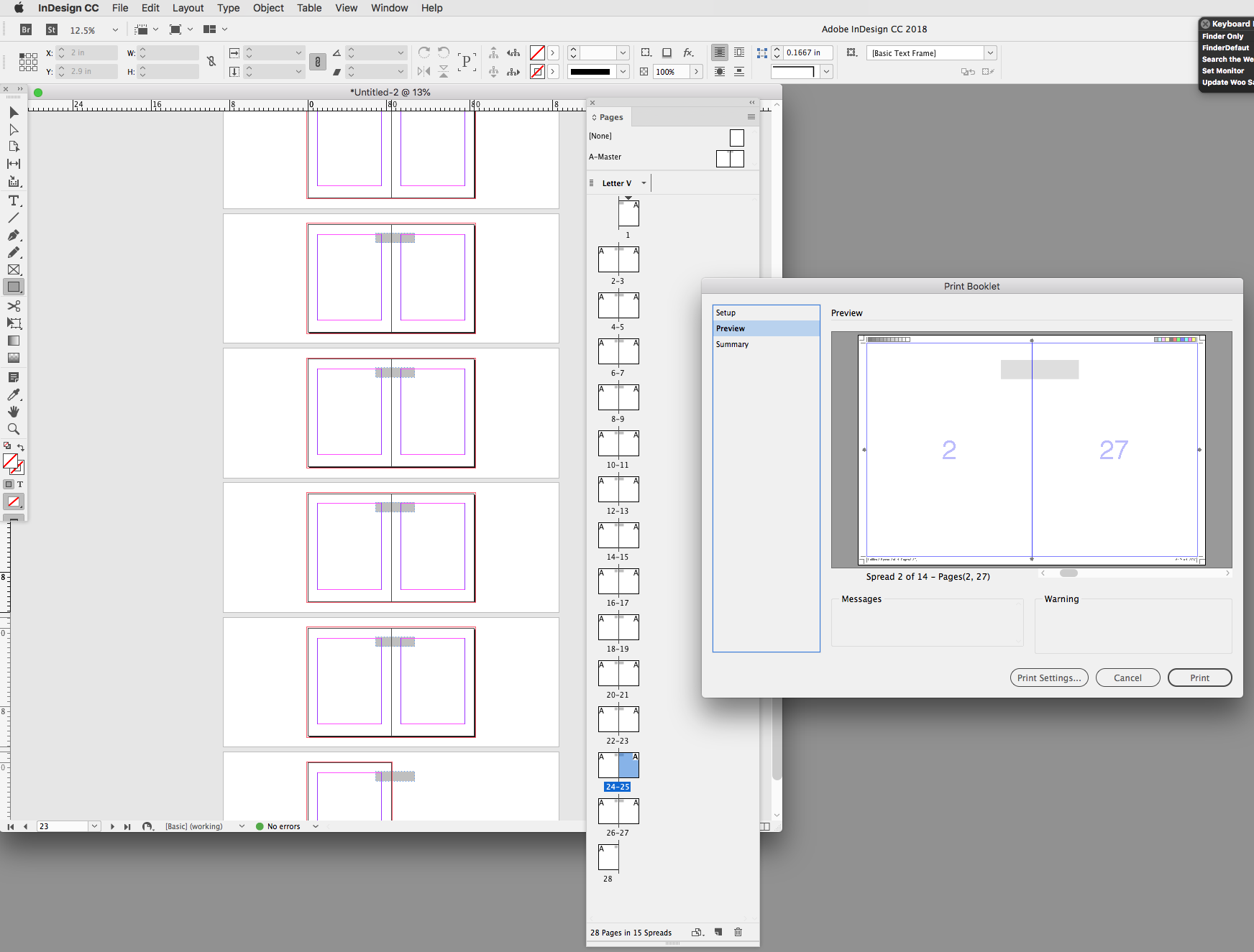

With Print Booklet the pages get reorder when you print. So here you can see I have a 28 page document set up as reader spreads starting with page one to the right of the spine. The Print Booklet Preview showing the page 2-27 printer spread
