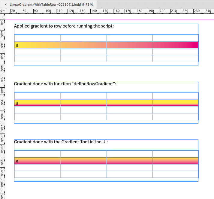

Apr 13, 2017 Apr 13, 2017
See the following screenshot.
The first table is just one I added to the frame without doing anything in regards of row height.
A default table where I added "a" to the first cell of the second row.
I assume that you expect a result like the one at the bottom.
I think, there is more to consider than only tables that flow with more than one text frame.
FWIW: Without a character in the cell your function is not working.
Consider the baseline value of the first insertion point of a cell to start out calculating anything.
Uwe
