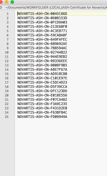

i have a data merge i am doing, i saved my  excel file as a .csv, but none of the commas show.  I am using textwrangler and i was wondering if anybody knew how to do a grep search to add a "," after each line break? i added a screenshot below so you can see what i see. i have lots of lists and i am looking for a fast way to add the commas from text wrangler.

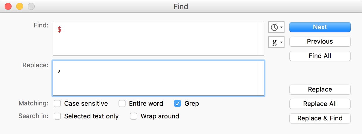

This GREP code will add a comma to the end of every line without having to do a two-step procedure:
However, I agree with Jongware, why would you want to do this? If the database has one field, it doesn't need commas, the end of line tells ID's Data Merge that the record has ended and to begin another one.
