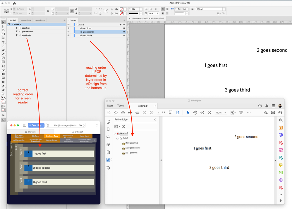

To further illustrate this look at my screenshot. I have three separate text frames randomly placed on the page. In the Article Panel I define the tag reading order for the screen reader which you can check in the exported PDF with PDFgoHTML (on the left).
The reading order in the PDF is completely different and depends on the layer order of the objects in InDesign – from the bottom up – I know this sounds weird. As you can also see in the Reading Order in Acrobat.
That the reading order in Acrobat has influence on real screen readers is not correct. The tag reading order is the important thing and that is defined in the Articles Panel – as long as you have the option “Use for tagging order in tagged PDF” turned ON.
