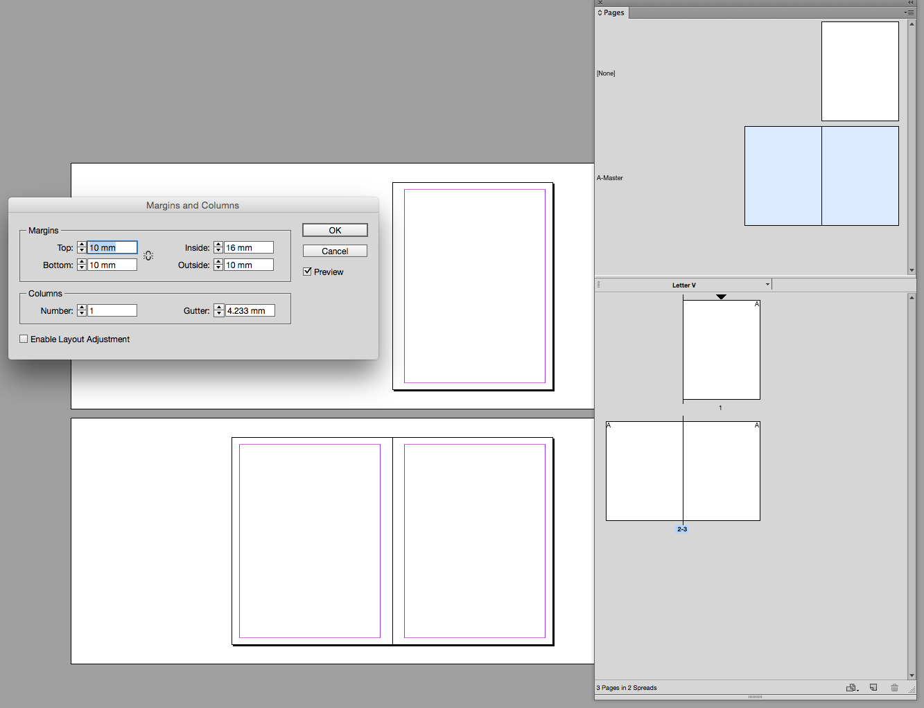

Sounds like you set the document up with Facing Pages unchecked and later went to Document Setup and checked Facing Pages–if you do that the pages become facing, but the masters remain as single pages:
If you open the master's Master Options dialog you can change the number of pages and create a spread
Now you should have Inside and Outside margins for the master sp

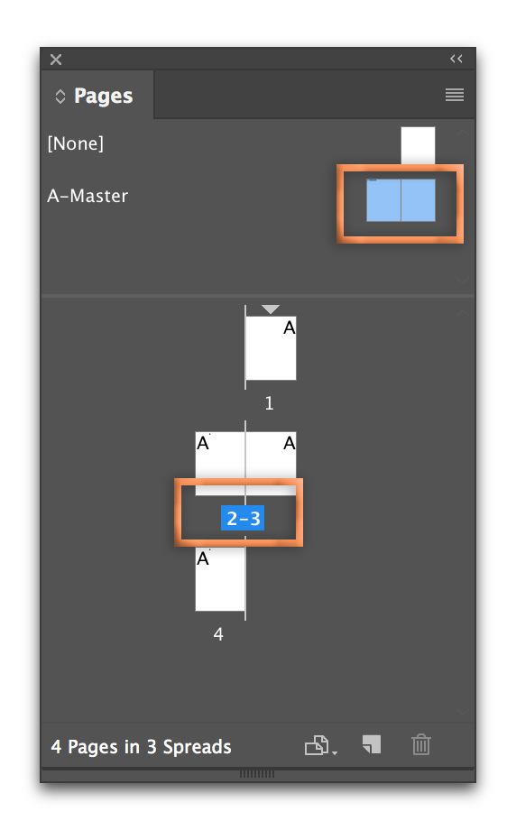

You have to pay close attention to the Pages panel when you use it to change pages. My tip is to double click the name A-Master (or B-Master or whatever you called it) to navigate to the master pages. The result in the the Pages panel is that there is highlighting behind the name and on the pages (Left image). This is different from single-clicking on A-Master, which leaves you on the pages you were on, and you just think you are on the a master. (Right image).
Set the margins using Layout > Margins & Columns on the master, and then apply that master to the body pages.

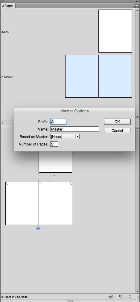

yet the margins settings for master pages doesn't have inside, it has left and right.  The settings for pages have inside and outside.
Now you should have Inside and Outside margins for the master spread

Community Beginner ,
Jun 25, 2017 Jun 25, 2017
Thanks Rob, spot on and stopped me going crazy!

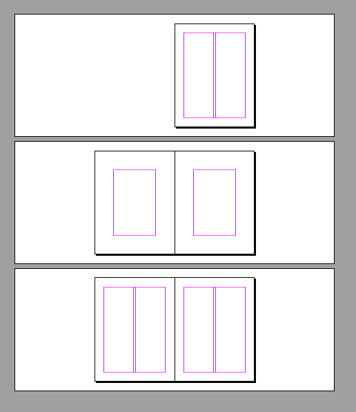

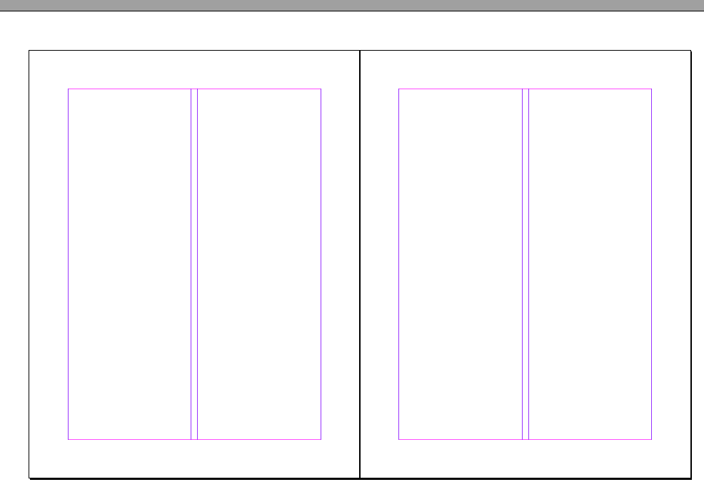

You also have to consider page overrides. The margins are like any other master page item—if you change a page's margins, that page's margins will no longer respond to a change from the master page.
So here I changed my A Master to two columns with 1" margins:
But pages 2-3 don't respond because I changed those pages to 2" margins with one column earlier from the pages not the masters.

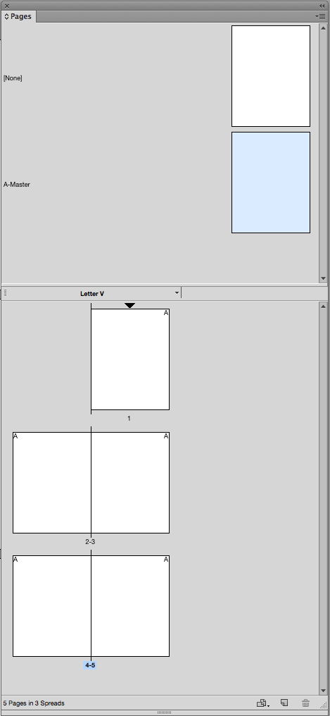

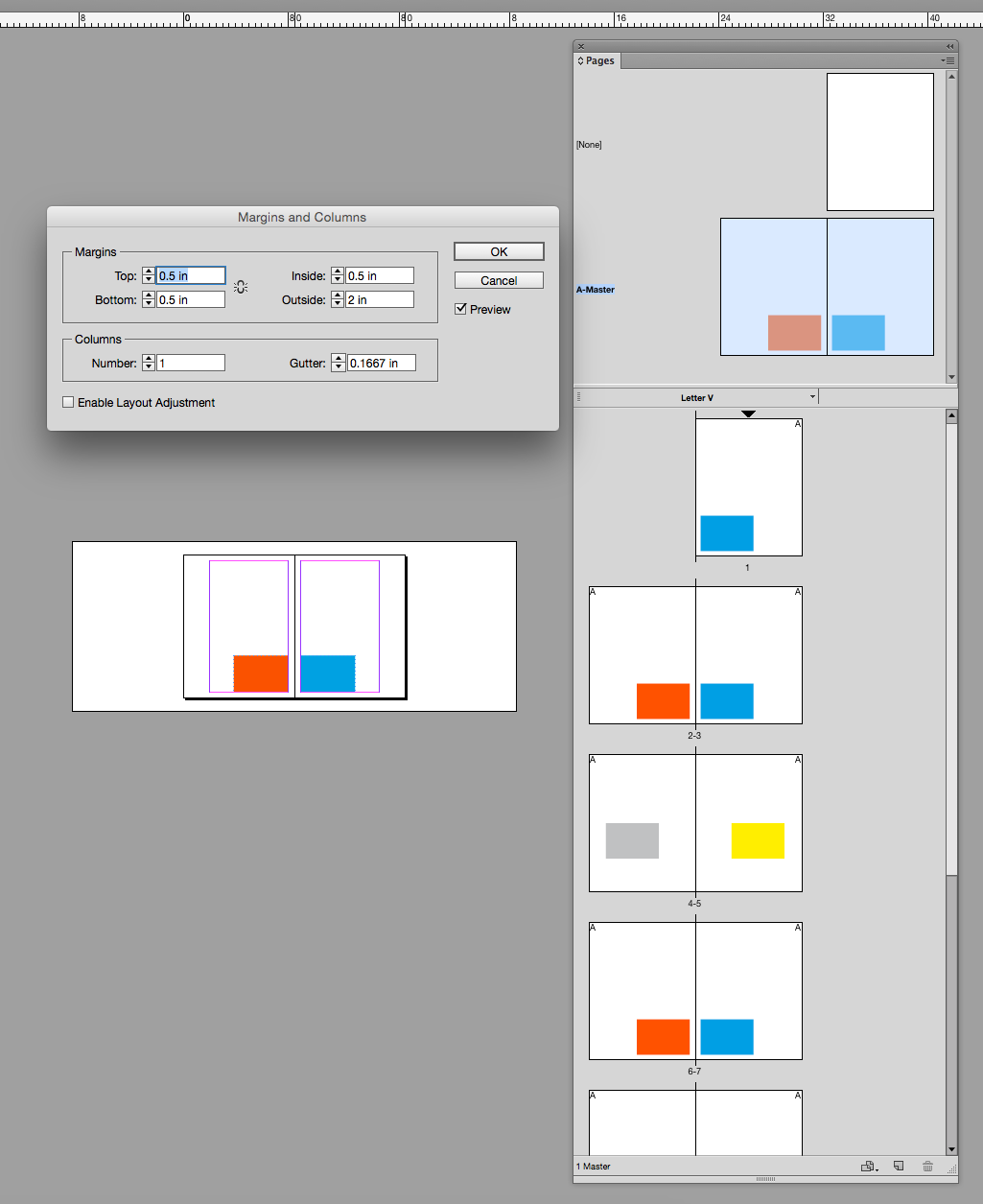

A master's margins work the same way as a master's page items.
So here all of the pages are linked to the A-Master, which has .5" margins and a master page item on each page:
I override the two master page items on the 4-5 spread, moved their position, and change the spread's inside margins to 2" (the 4-5 spread is selected in the pages panel, so the margin change is only applied to those pages).
If I go back to the A-Master, move the two page items to another position, and change the spread's outside margins; you can see all of the pages except for the 4-5 spread respond to the change. 4-5's margins and page items don't change because they were overridden and moved.
