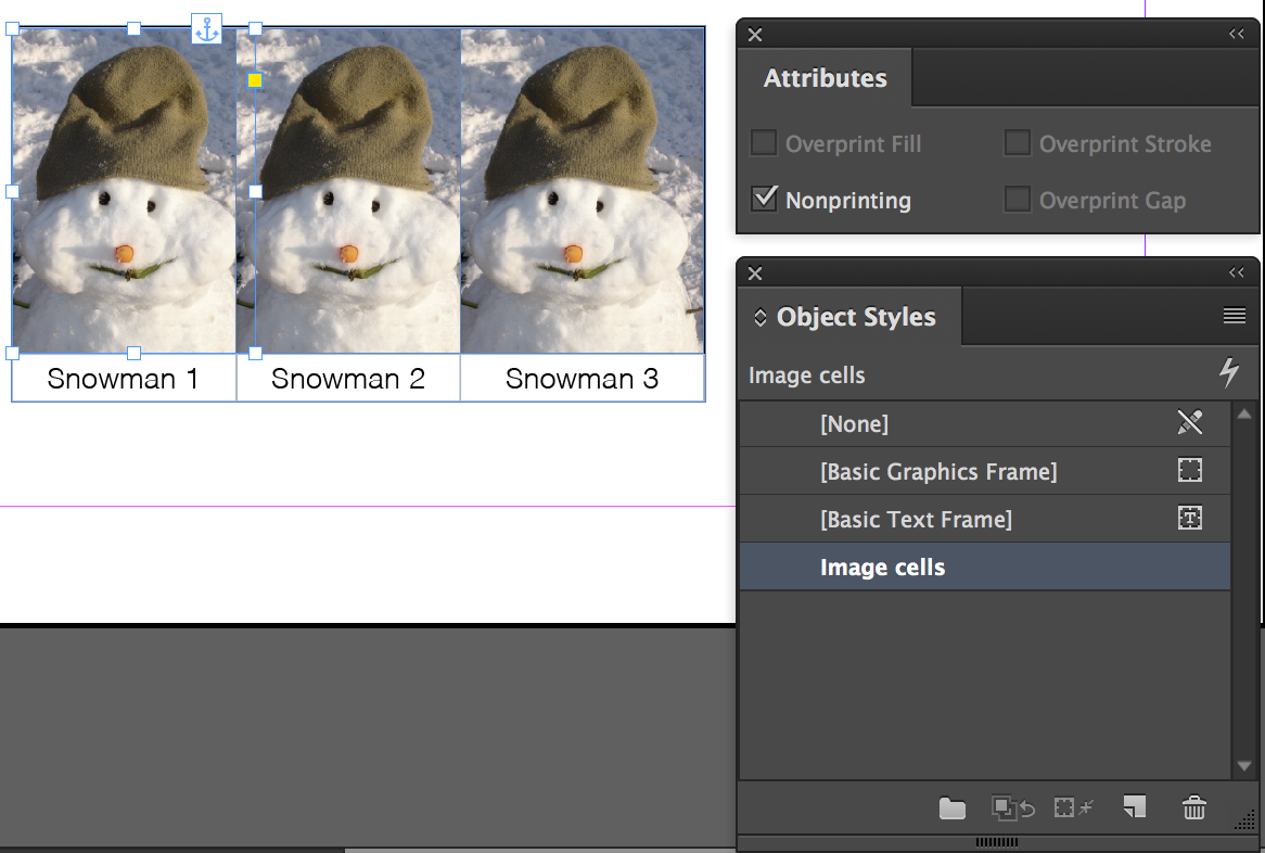

Hi Jo
I don't believe you can have different layers within a table.
A workaround for your problem might be using Object Styles.
If you apply an object style to your images and choose for them to be 'Non printing' in the 'Attributes panel' Found in the Window Menu under Output.
Then if you wish them to print you can change the frame to 'printing' and update your Object style.
It's as quick as switching on an off layers.
Hope this works for you.

Guide ,
Mar 28, 2017 Mar 28, 2017
Hi
Nope, you can't have "different layers within a table".
Your request could probably be handled in many different ways/workarounds.
Question is: do you really need a table or could you think of another way to design your doc, without table, meaning you'd be able to use separate layers.
Anyhow here's a workaround, keeping the table structure:
- create an object style and apply it to your image frames (using find/replace Object may be useful and fast)
- In the object style, go "Text Wrap & others" and check "Non printing".
- The result is that you can see the images in Normal mode, but they won't export.
- Uncheck "Non-printing" option to reverse the process and export the document with images.
New Here ,
Mar 29, 2017 Mar 29, 2017
Many thanks Vinny,
I have implemented this solution along with Alma's feedback. Really appreciate your very prompt help!
Jo
