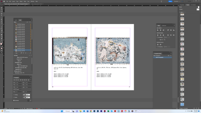

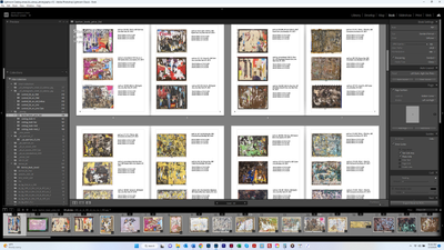

Does InDesign have a feature where you can display your images as thumbnails to see many of them at once?  Sort of like what you can do in Lightroom (screen shot below)?  I looked through the View tab but didn;t see anything like that.  Thanks.

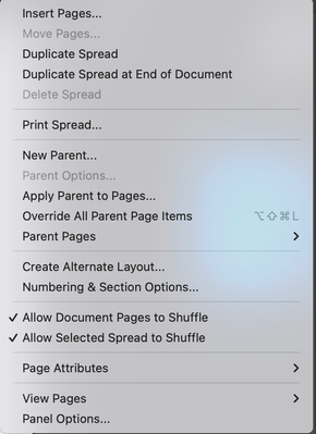

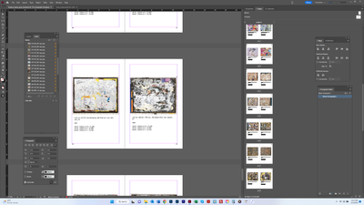

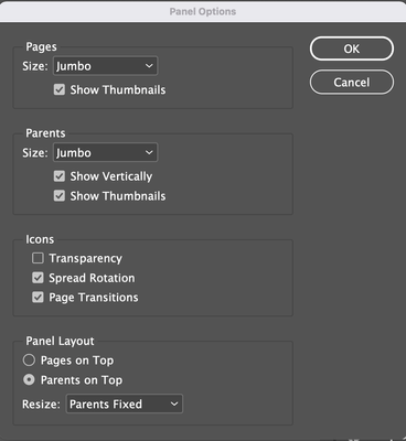

In the Pages Panel, you can select from the side menu Panel Options > Pages Size and select Jumbo from the drop-down menu.

Advisor ,
Feb 03, 2023 Feb 03, 2023
I can't find Panel Options.  Can you point me to the right place?  Thanks.
Advisor ,
Got it, thanks.  The thumbnails are pretty small, and they appear only 2 to a row.  Are there options for making this presentation different?

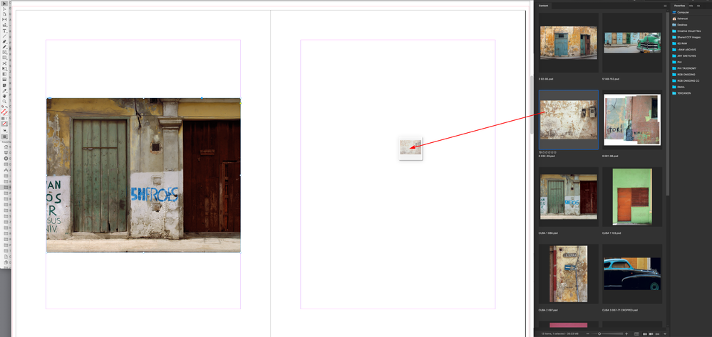

Just to clarify, are the images you want to see already placed in your document, or do you want to see a folder of images in a grid so that you can select and Place?
If it’s the latter you can drag and drop from Bridge:

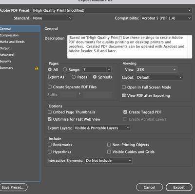

What about exporting the InDesign document as PDF spreads and setting the View to say 25%?
