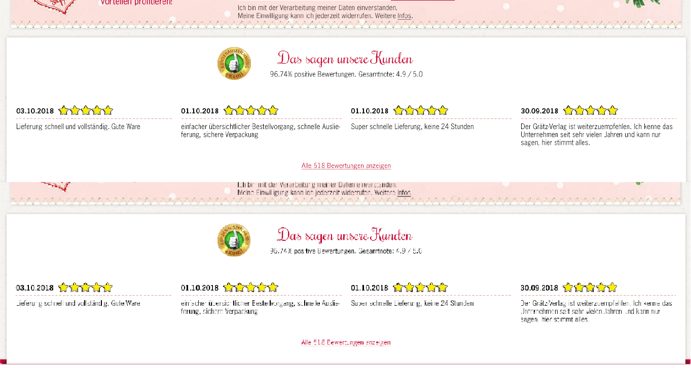

I have some trouble with InDesign recently. While I was fully satisfied with a small project, I copied the file and replaced the images in my rectangle frame. This time, I linked the images instead of just paste it in the frames. Then I saw a huge differece in high quality performace: The Quality on the pasted images are much better than the ones I have linkes. No matter if they are embedded or just linkes. The quality is not as good as I get it when I just paste and place an image from the same soruce.
First I thought it was a cache, gpu driver or whatever problem. I just updated to V14, but the issue started in V13.
Now I opened a similar file the one I am working on is based on. And there it was: The issue is HOW I link an image into a frame.
There has to be some options on how the linkes images are displayed.
The upper one is the one with copy and past, the bottom one is linked.
The qualities are on high of course.
As I mentioned: Cache is empty, Driver is updated, InDesign is updated on V14, Computer restarted and so on.. I am pretty sure this is an options issue. Would be great to get some help.

Forgot to mention: The exported file (PDF) looks fine. There is no problem. Its just the preview.
I am using a PNG file. JPGs are all fine. But still: Why is there a difference between link and paste a file?
The picture you can see is no manipulation. its two frames with exactly the same source of image.
One is copy paste, the other one is linked to the source file (same with embedded files).
Its a six pages document so the view is all set on high quality. I know how that works on each frame. But my question is why it displays differently. Because I am often working with embedded PNG files.

In the Info panel, what is the psi/dpi indicated for each option?

Eric, I appreciate your help. But it seems we are getting out of the main topic. It is a large project I am presenting these files directly to the customer. Its about 1920px by 5000ish so 7.5mb is perfectly fine to me. The picture is not compressed and as I mentioned before: The source is EXACTLY the same!
I cant even imagine that the copied source has more quality than the one I am linking or embedding. I have tried several files with the same width. Same issue! There has to be an option or something making the linked image compressed or something. And thats the part I dont get: Why am I getting different preview qualities from the same file? Thats the issue, not the compression!
I dont want a bypass. I need a solution or at least an explenation why InDesign is handling the preview differently while using the same file! You understand that running away from problems is never a solution
