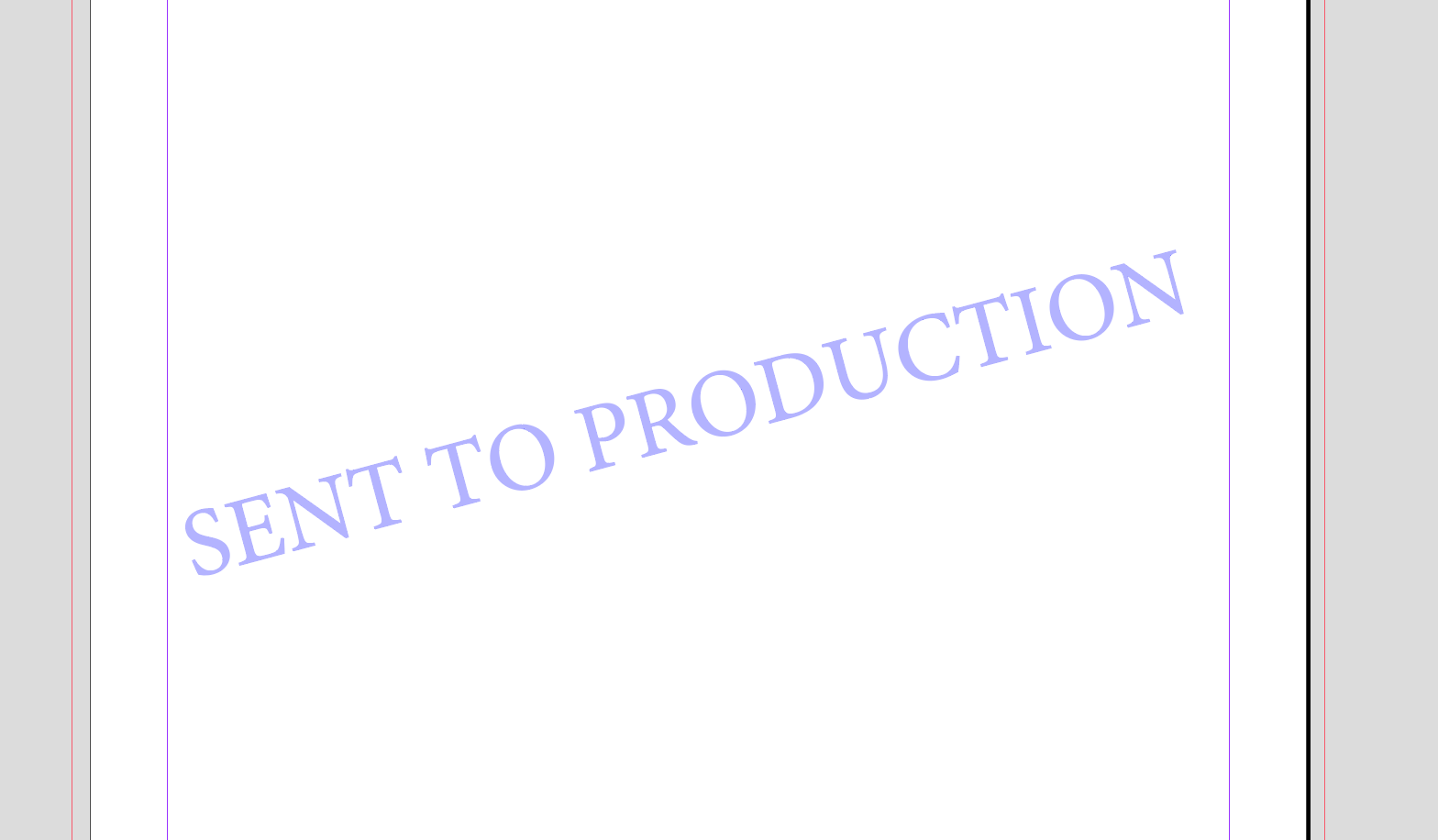

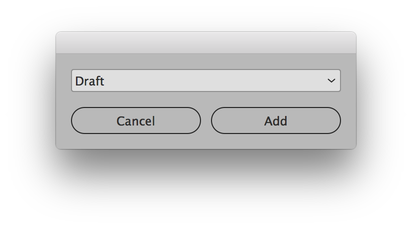

People's Champ ,
Aug 30, 2017 Aug 30, 2017
Something like that ?

Given all Dom operations here, wouldn't that be easier to work with snippets ? You do them as wanted, place them and eventually change date right away.
FWIW
Loic
var main = function() {
var doc = app.properties.activeDocument;
var snippet = File ( Folder.desktop+"/snippet.idms" );
if ( !doc ) {
alert("Need some open documents" );
return;
if ( !snippet.exists ) {
alert("Couldn't find snippet !" );
return;
var ui = UI();
if ( !ui.show() ) return;
snippet = doc.layoutWindows[0].activePage.place ( snippet )[0];
app.findTextPreferences = app.changeTextPreferences = null;
app.findTextPreferences.findWhat = "##mention##";
app.changeTextPreferences.changeTo = ui.mention;
snippet.changeText();
var date = new Date();
app.findTextPreferences.findWhat = "##date##";
app.changeTextPreferences.changeTo = date.toLocaleDateString();
var UI = function() {
var
u,
w= new Window("dialog"),
ls = w.add('dropdownlist', u,["Draft", "Sent to production", "PDF Generated"] ),
btnGp = w.add('group'),
koBtn = btnGp.add("button",u,"Cancel" ),
okBtn = btnGp.add("button",u,"Add" );
ls.selection = 0;
w.preferredSize.width = 300;
w.alignChildren = btnGp.alignChildren = ["fill","top"];
koBtn.onClick = function(){ w.close(0) };
okBtn.onClick = function(){ w.close(1) };
ls.onChange = function() {
w.mention = ls.selection.text;
return w;
var u;
app.doScript ( "main()",u,u,UndoModes.ENTIRE_SCRIPT, "The Script" );
The Snippet
Of course it lays on a shared ressource but in worst case, the xml string may be included in the script.
