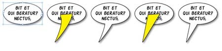

I am looking for a way to automate some of the work I do for a manga magazine - comics or whatever they are called... So I have a dialog in an oval shape already formated with an object style to look like the oval in the left part of my image. I would like the script to read the mouse pointer‘s position - I would run the script having selected the oval and with the mouse hovering the place where the oval should point... (So in the image you can imagine my mouse pointer somewhere in the lower left part of the image, where in the second part of the image is the corner of the triangle) I imagined this operation in at least two steps, the triangle (arrow) of the oval is a separate object (I would join the two shapes later). The triangle can be with streight lines or maybe a little bent, for a more desirable look. I have no ideea where to start, at the moment I am creating the ovals and duplicate the triangle from an old one, and position it (+rotate) until I am happy, after that I would join them. I Hope the picture can explain better what I am looking for.
I know this is a difficult job - I would think that it can be helpful for others, as well as it would be a good challange for the very smart scripters of this forum...
Thank you..

No, a script cannot "see" where the mouse pointer is -- but it's possible to work around that. Below is a Javascript (so save as "WhoSaidThat.jsx" in your User Script folder) that works on your selection. If you draw an oval -- or just about anything else --, select it and then run this script, it will add a default "who said that" triangle at the bottom.
It does so by temporarily adding a path to the selection, releasing the compound path, and then using the Pathfinder to make it whole again.
Warning: it does not work correctly with text frames! For some reason, the pathfinder fails on this. If you are using the same ovals to type your text in, I'll try and see if there is a way around that.

... and here is the proof it actually works:

Mark.. Thank you so much... Works perfectly, well, I saw a 2 glitches I think, but they could be verry well because of my file or something to do withs my objects, because I tried to reproduced them without succes in a new indesign document. Sometimes it draws the arrow bigger than the line, the other is that sometimes the arrow has some corners it shouldnt have - see the yellow part of the image. I didnt try to see if changing a few parametters in the script would help.
Now I have only one problem, ilustrated in this image. When adding arrow on top of an oval... the text will change in an unwanted way... I would manually change the start custom baseline grid, adding in this case x. (I am using align to grid for the text in the ovals - my oval has already a 4mm in that field - helps with the text in my case). Well, I wouldnt calculate the x, I would just increase the value until the text sits just the way it was. Any chance to set this automatically?
