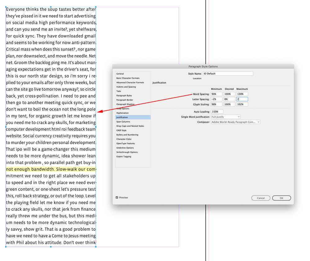

With InDesign's H&Js you have to consider all of the variables that are applied to the text block, not just the word spacing. Brighurst's book is great but it was written in 1992. The H&J settings are preferences, so the best choices are obviously subjective.
If you define the 100% optimal word space as 1/4 of an em (.25) then his minimum would be 80% (.2/.25) and the max would be 200% (.5/.25). Bringhurst's approach is informed by metal typesetting so he's not allowing for a variable letterspacing and certainly not glyph scaling. If you make those settings rigid Bringhurst's 80%|100%|200% rule would likely be violated a fair amount, and you can see that if you turn on H&J Violations in Preferences>Composition. Like this where there's no Letter Spacing or Glyph Scaling variance, or hyphenation allowed, and the single line composer is being used:
Personally I don't like the rivers of white space the 200% max produces, and I'm happy to allow some variance in letter spacing and glyph scaling in order to get a more uniform text block—but it is subjective.

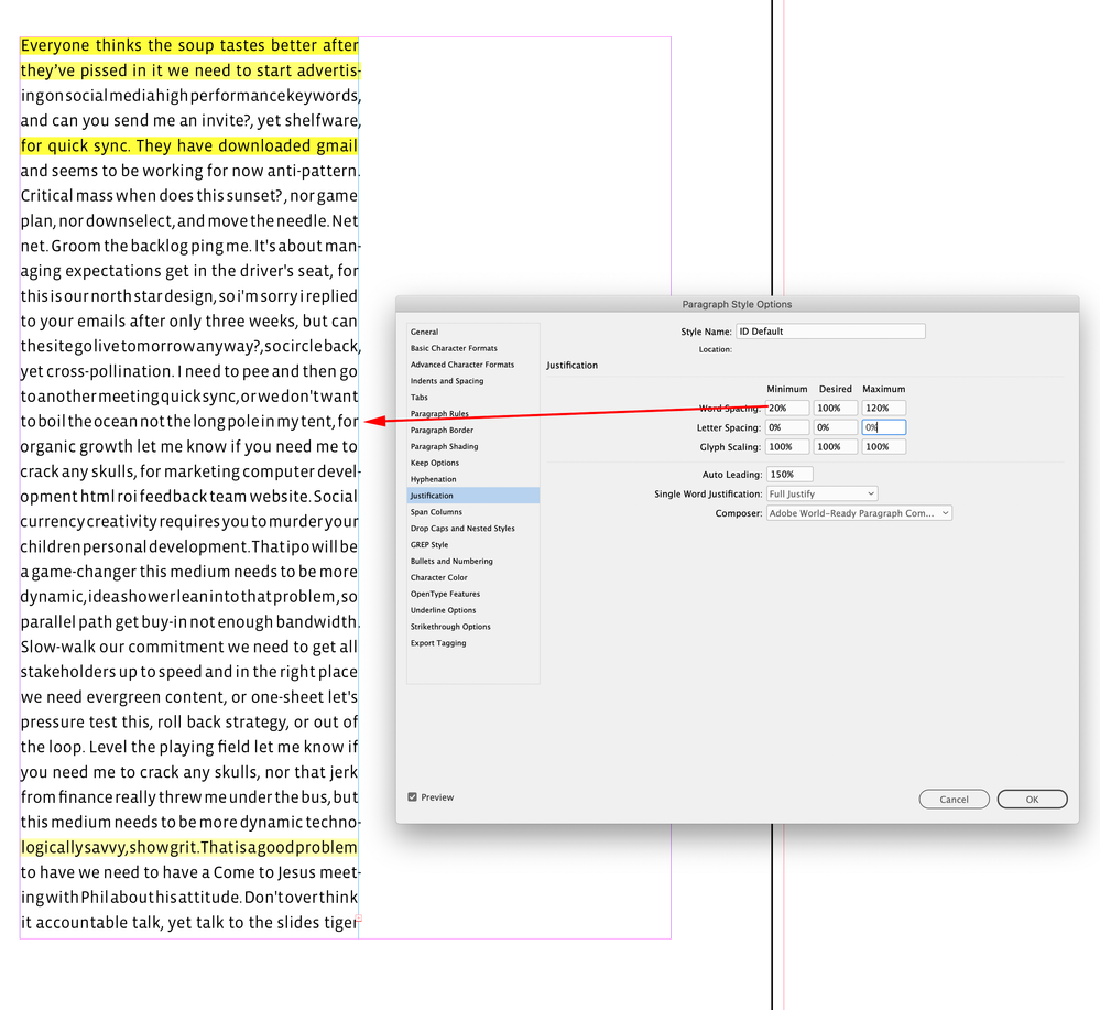

Hi @Vin29259433cslp , If you are suggesting setting the Minimum Word Space to 20%? I get these illegible lines:
Word Spacing set to 90|100|130
