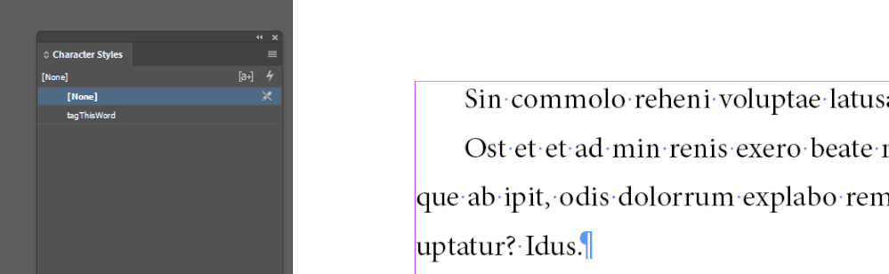

1) I made a character style "tagThisWord" that had a character width of 1% and a bright ugly magenta color
2) I typed my fictional programmers' desired HTML bookmark id right into the body text in InDesign
3) I applied the "tagThisWord" style to the bookmark text:
After export, I popped the publication.html open in my preferred text-editor-that-has-regex-support and I replaced the div ID of any span that contains the tagThisWord class with the text content of the span, leaving nothing behind:
Find:
(<span id=".+?".* class=".*tagThisWord.+?>)(.+?)(</span>)
Replace with:
$1$3<span id="$2"><\\span>
