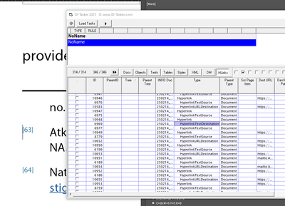

@Debbie5C13
Looks like you've at least one "bad" Hyperlink:
Source:
and Destination:
But finding this was an accident.

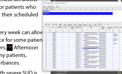

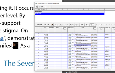

@Debbie5C13
Hyperlinks "38" and "39" - in the main text - are pointing on themselves:
"38" in the Footnotes - also points on itself:

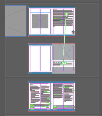

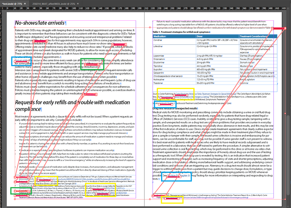

Feb 16, 2025 Feb 16, 2025

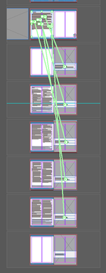

@Debbie5C13
I though about your Hyperlinks - and I think this would be the best and most practical solution 😉
(I've copied part of the text to a new document - quicker for me to test.)
For better visualisation - extra frames:
- marked in Yellow - external hyperlinks,
- marked in Green - bad hyperlinks, that link on themselves,
- marked in Blue - hyperlinks to your document.
Those are a TextFrames linked together - Hyperlink's Source -> Destination.
For now - just empty frames, with Object Style applieed and on a separate Layer  - but there can be name of the Hyperlink in the source / destination TextFrames - and in case of the external destinations - that for obvious reasons can't be "linked" this way - name of the document and name of the text anchor / bookmark / page number or URL address.
If you like my idea - I can process your whole document and send it to you privately.
[edit]
After processing WHOLE original file - "Introduction" page selected:
("unnecessary" pages has been removed - only section header pages left)

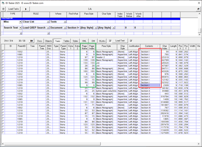

After digging a bit more - currently, "Section 1" has only ONE reference in the text:
But, In the text, there are more instances:
(Marked in Red - texts - marked in Green - pages)
and only one Hyperlink:
But, as you've said Debbie - you're in the middle of editing this file, right?
