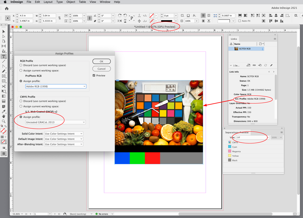

Hi @Alex37649926gy3i , The document’s assigned CMYK profile (Edit>Assign Profiles...) determine the CMYK values and appearance you will get on a conversion from RGB to CMYK. If the print destination is an uncoated sheet on an offset press it will be important to at least assign an uncoated profile, e.g. Uncoated GRACoL 2013.
Your printer should recommend the profile to use, but they may not—in that case use one of the InDesign uncoated profiles and make sure you get a contract proof before going to press.
With an uncoated profile assigned, all you have to do is turn on Overprint/Separation Preview in order to get a soft proof and the output values of the expected Document CMYK output. So with Overprint Prview off this AdobeRGB image displays with the full RGB gamut:
With Separation Preview on the appearance and output numbers are the expected Uncoated GRACoL output:

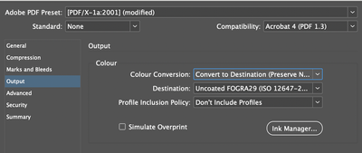

Thanks everyone for the replies. My follow-up question is this: is the best workflow to export my entire InDesign file to a CMYK PDF? When I do this, with "convert to destination profile (preserve numbers)" and Uncoated FOGRA29 as a destination, my PDF looks absolutely fine. Is this an accurate reflection of what the print will look like?

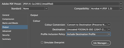

However, when I have my export settings to "inlude profile", my PDF export looks rather pale, akin to how my InDesign document looks when I proof the profile of Uncoated FOGRA29.

Moreover, I now see that my printer requests a PDF/X-1a file and FOGRA39, but I know there is no uncoated FOGRA39 profile available - only coated.
Fogra 39 is a profile for coated paper. For uncoated paper, you could use Fogra 29.
May 27, 2024 May 27, 2024

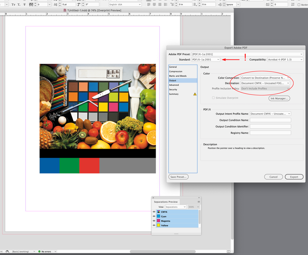

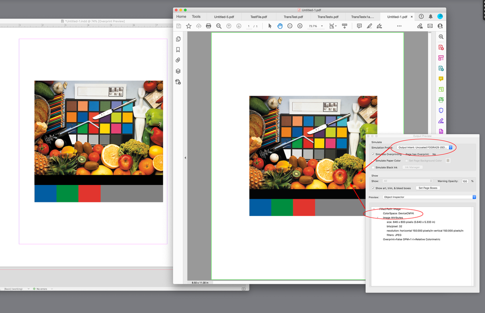

It’s important to note that the PDF/X-1a preset Standard doesn’t allow embedded profiles. PDF/X Standards do include an Output Intent Profile for handling the softproof preview of document CMYK values in Acrobat, but document CMYK colors Export with no profile. With PDF/X-1a all color is converted into the Destination CMYK space so you don’t need a CMYK profile to be embedded because there will be no further color managed conversions—the PDF’s CMYK values are correct for the destination press.
Also, you should have the same Uncoated FOGRA29 profile assigned to the document. In that case you don’t need to use Prrof Setup/Proof Colors because Overprint/Separation Preview is already correctly proofing to the assigned CMYK space.
