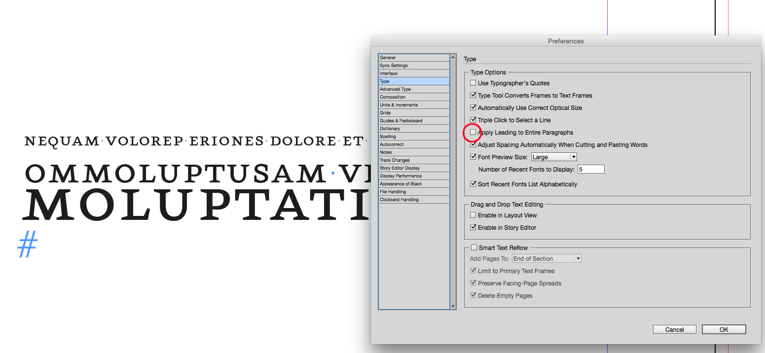

I'm having trouble finding out a quick and easiest way to evenly distribute lines that contain text of different font sizes.
You don't have to cut the text into different frames to adjust the leading on individual lines of text. In Preferences uncheck Apply Leading to Entire Paragraphs:
Now I can select line 2 (triple-click) and adjust its leading relative to line 1 without affecting the other lines.
