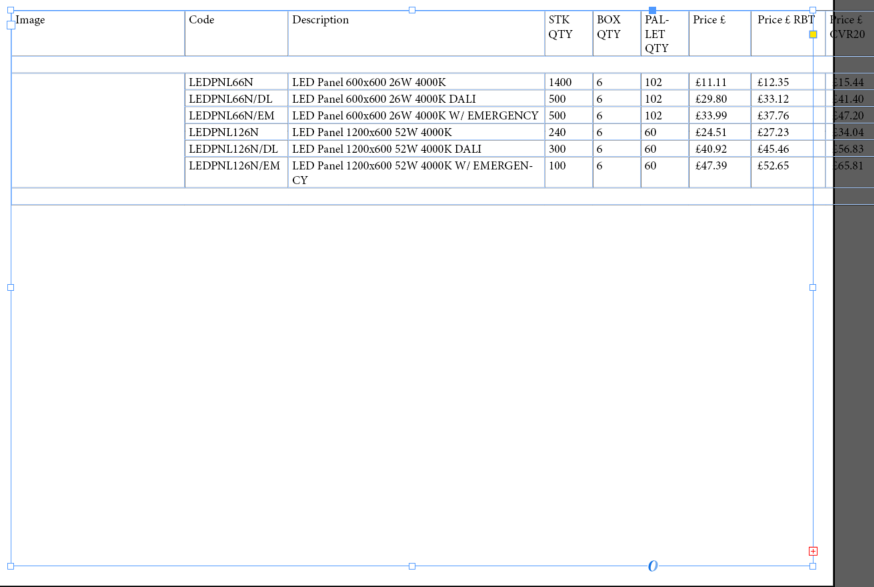

How do I paste a big table to indesign from excel, I try to paste the table but it doesn't all go on one page?

Use file > place and select the range you need in the options. After that, you'll have to resize things to fit.

@James3669094303ct
There is an overset - red "+" in the bottom-right corner - probably a row after the last one visible is too high and doesn't fit - try to make TextFrame much higher.
It can be a graphic or forced page break.
Try to reflow this text.

How do i reflow the text
Apr 18, 2024 Apr 18, 2024
Withthe text tool clcik the red plus, then click where tupi want the text to start flowing again.
