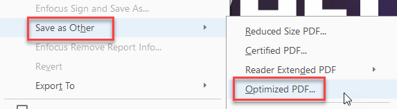

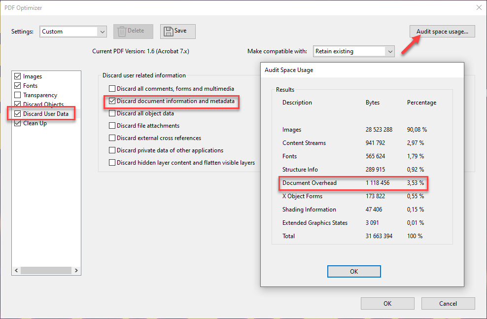

In my experience, PDF files placed in InDesign and then re-exported back to PDF, sometimes cause it to grow in size significantly. For example, a single page may weigh more than all the other pages. It's easy to see if you split the file by one page.
To solve the problem, I do the following:
File > Save as other > Optimized PDF
Then click the 'Audit space usage' button to check Document overhead which in some cases may take even 90+ %!
To remove this unnecessary data, select Discard user data tab, turn on Discard document information and metadata and click OK.
