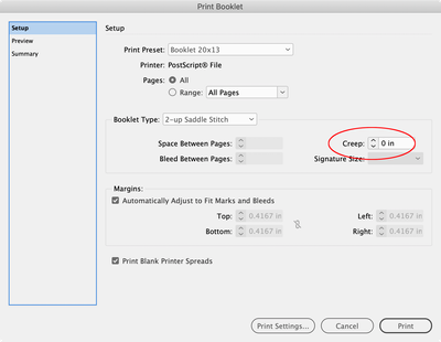

The bleed and crop settings don’t have anything to do with imposition. Unless the output is to some low end printer/copier (e.g. Kinkos) the imposition wouldn’t be 2-up—it would more likely be imposed for the full press sheet, which Print Booklet can’t do:
And if there are more than 8 pages there would be some creep adjustment. How are you coming up with the Creep setting?

That is exactly what I did, I gave them a pdf file that I generated using the Print Booklet function. That's why I suspect it's only for the person doing the proofing. They didn't ask for anything specific beyond that, so I just kept everything else in their defaults. I didn't have to set up creep because like I said I don't believe they will use the booklet version in actual production anyway.
