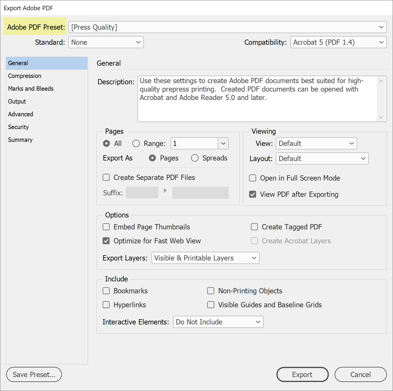

Summarizing how to make a PDF for print from InDesign...
These are basic all-purpose settings that will work for most PDFs that will be printed. More advanced settings can be made per your print shop's requirements.
  1. File / Export
  2. Navigate to a location to place the PDF file.
  3. Select "Print" (not Interactive) from the Save As Type DropDown menu.
  4. The next dialogue are the controls for how the PDF will be created. From the Top part, select...
    • One of the predefined presets, something like Press Quality or PDF/X-4

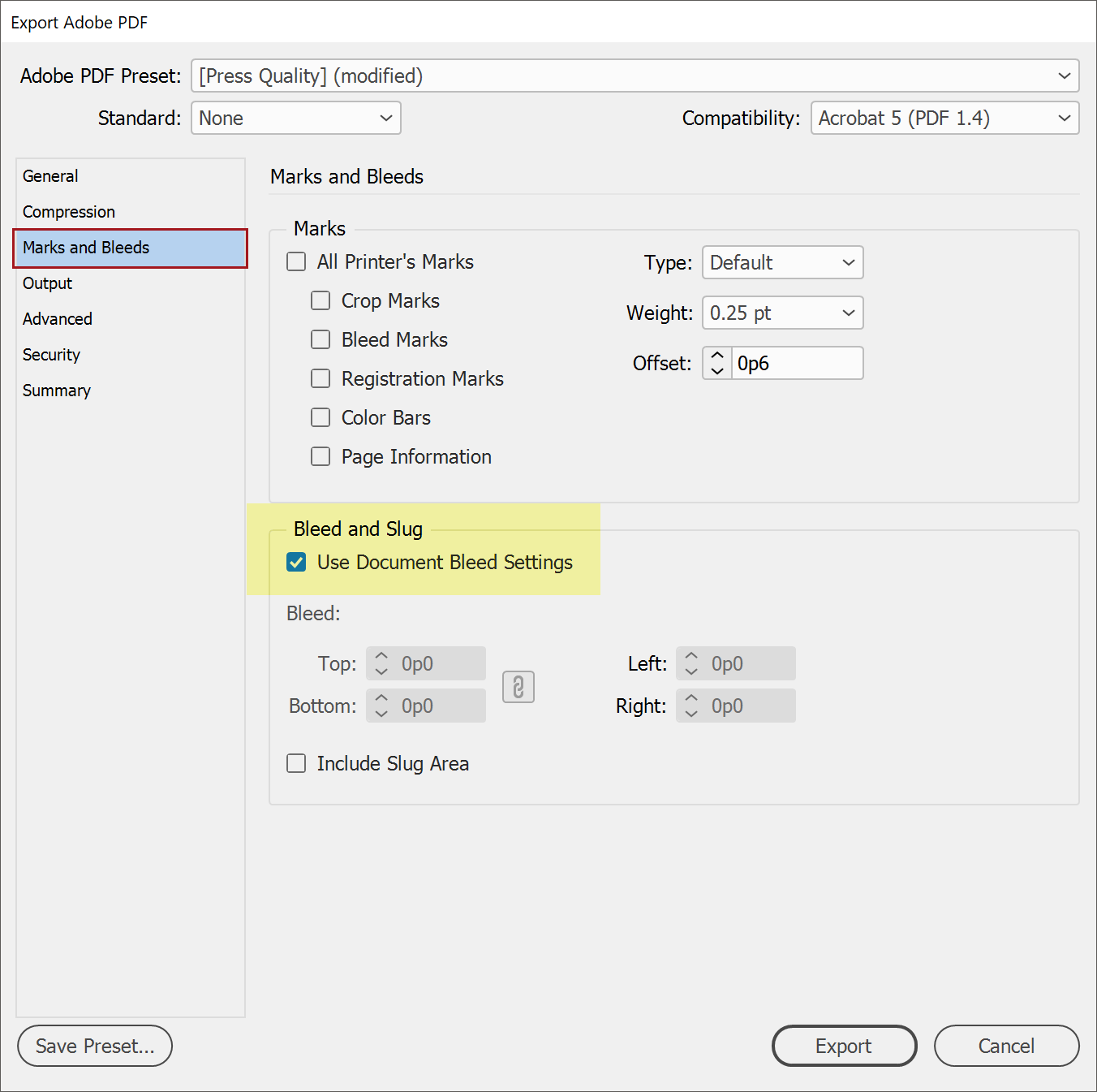

  5. From the Marks and Bleeds section, select
    • Use Document Bleed Settings (hopefully, you set up your document with 1/8" bleed on all trim edges)
  6. Click Export to create the PDF.
As I said above, you can alter these settings based on what your print shop requires, such as a higher resolution or different color settings under the Advanced settings section. But the above default settings pretty much work for most generic printed products, like CD covers/inserts.
If you did indeed set up the InDesign document to be 4.724" square, then these settings will produce a PDF that is 4.724" square. They do not changed the document size.
