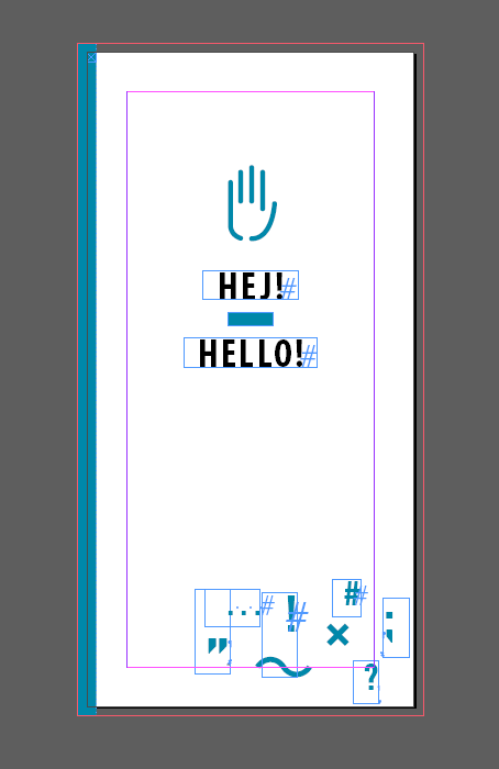

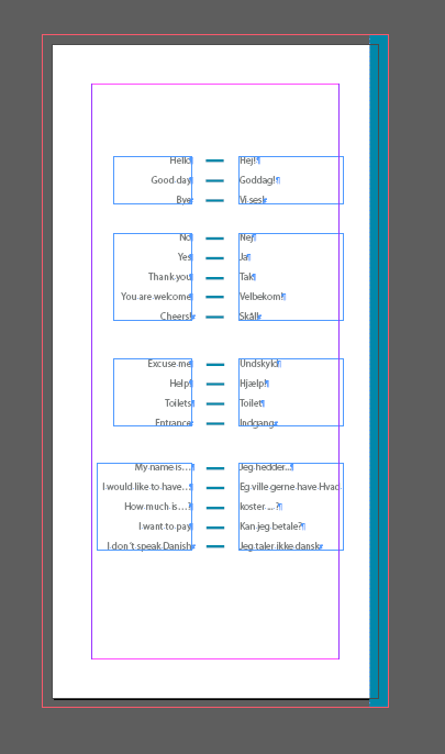

I've just received the printing spec for this project. I'm not an expert in printing unfortunately. It's a 105x210mm guide.
I have to export it in single pages, they asked for 3mm bleed in the outside but not in the inside, (and in all sides for the cover).
My question is: how can I set this differences in the final pdf? Because the "inside" is sometimes on the right and sometimes on the left, depending on the page of course.
If I export 3mm of bleed on all the sides, I think the crop marks will be wrong for the insides, am I wrong?
I could export 1 pdf with all the pages that goes on the left (with 0mm bleed on the right because it will be the inside), and 1 pdf with all the pages that goes on the right (with 0mm bleed on the left side), but I'm sure there must be a correct way to solve this problem. Can you help? Thanks

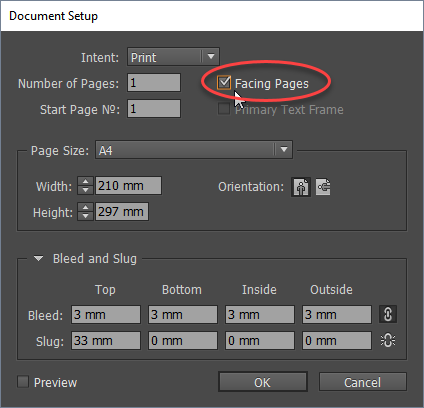

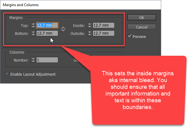

Use bleed for managing outside settings and page margins for the inside? As this is essentially a guide anyway I'm not sure what you are getting at?
Crop marks will appear based on what the page dimensions have been set as....
Or in a visual representation:
What am I missing?

Also: with regards to the set up for a book why don't you use the facing pages option?
This should allow you to mitigate your worry about the internal bleed?
