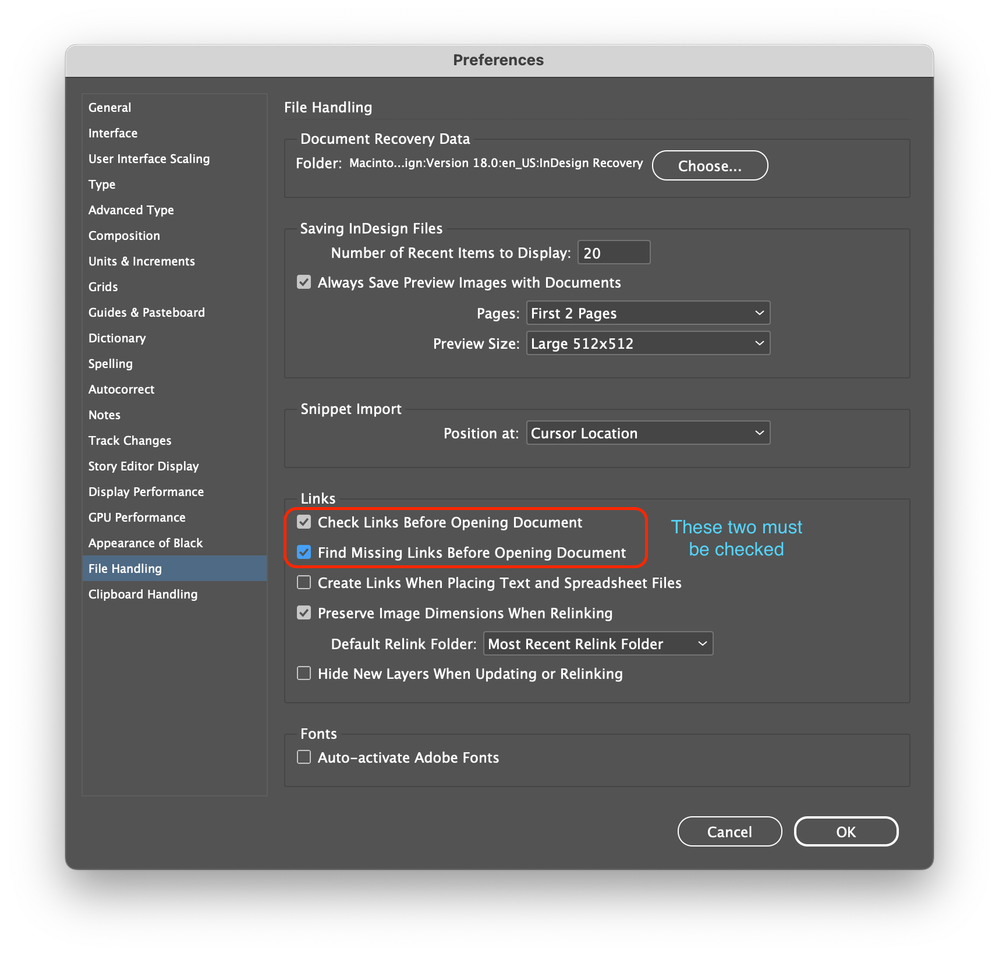

Final update: it turns out that the error occurs due to a couple of preferences I had turned off. These guys:
So it does relate somewhat to the preferences I had turned off (don't remember turning them off, by the way—probably trying to speed up a huge document long ago). But given that the link in my demo file *wasn't missing*, I still consider this a bug and I will add a clarifying comment to the bug report Peter lodged.
Thanks everyone. Feel free to test again with "Find Missing Links Before Opening Documents" turned OFF, but I'm pretty confident that was it.
