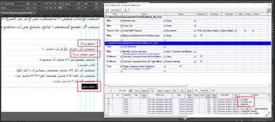

Here is the whole process - based on the file provided by A2D2 -- which shows, that ID-Tasker is perfectly fine with RTL texts as well.
THIS IS VERY IMPORTANT - Endnotes option NEEDS to be set to "On a New Page":
Otherwise, it will create bunch of separate TextFrames for each Endnote.
Let's load Footnotes in "( )":
As per screenshot - Arabic text is displayed in the IDT's UI as well.
I want to convert only those 3x selected:
After conversion - references are doubled:
And fixed:
Now, what's left, is to test IDT on some Far East document.
Even the free version of ID-Tasker can do the whole process semi-automatically - each Footnote that needs conversion, has to be pre-selected - double-clicked on the list of the found results - which BatchMode do this automatically in the full / paid version.

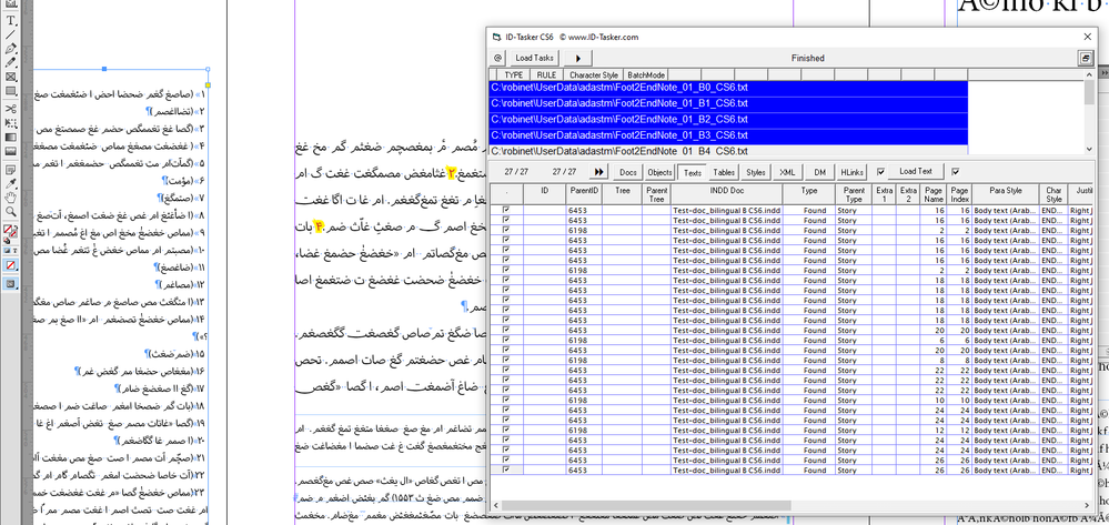

And done:
5x Tasks and Footnotes in "( )" converted to Endnotes - extracted and renumbered.
