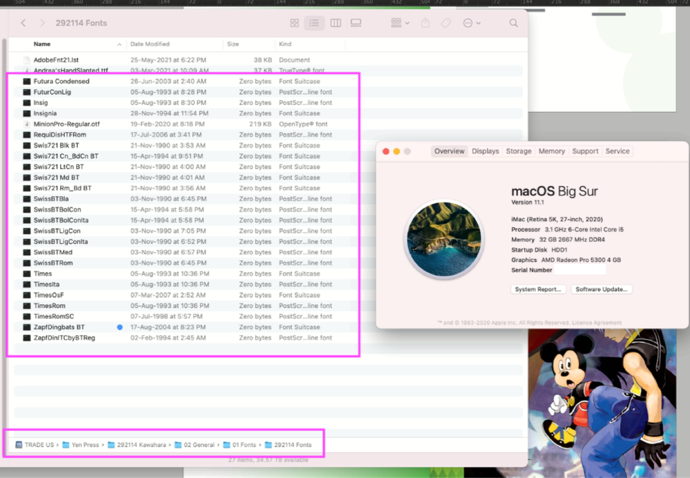

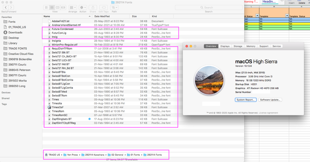

Jun 01, 2021 Jun 01, 2021
Hi
Still I have issue with Mac OS 11.1 please find the attached 2 screen shot. Same font folder from server but different OS.
I found the below statement from Appleinsider.com
The latest version of macOS, Big Sur, still supports Type 1 fonts on Intel and Apple Silicon machines. For now.
Participant ,
Jun 07, 2021 Jun 07, 2021
Hi
Any one come across the above issue in MAC OS 11.1 please let us know your thought.
