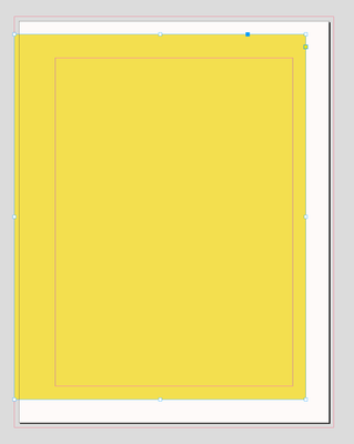

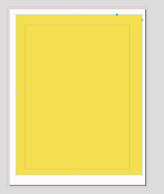

Hi @dublove , In your example do you want to move the selection or extend it to the bleed? Or, consider this more ambiguities example:
Should the rectangle be moved or extended? Where? All four sides? One, two, three, or four?

It's moving.
That’s what you want, but I would want to extend the object, so the bleed is added without moving the text content. How would Distibute Objects handle the diffent needs?

Apr 11, 2025 Apr 11, 2025
I can't understand.
If you are adding a bleed for print, you wouldn’t want the text to move when you add the bleed to the text frame.
This:
Not this (which would happen when the text frame is moved):

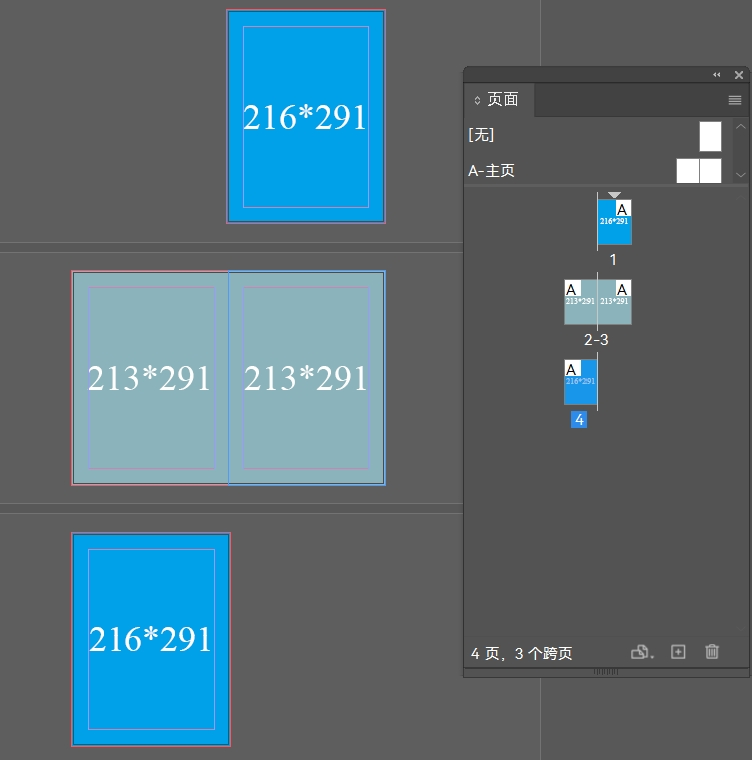

Guide ,
Seems to be off the original topic.
What you're saying isn't the same thing as what I'm saying, is it.
The version is fixed.
The center pages are all 3-sided bleeds except for the 1st and last pages which are 4-sided bleeds.
That's fixed.
