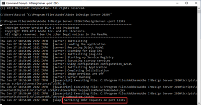

I started an instance of InDesign Server on a SOAP port from Command Prompt
  1. cd "C:\Program Files\Adobe\Adobe InDesign Server 2020\"
  2. InDesignServer -port 12345
And now I have it up and running:

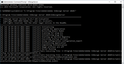

When I start IS with ‘InDesignServer’ command (no port), I get this message:
If no configuration name is given, "configuration_portnumber" is used; if no
port number is specified, "configuration_noport" is used. To use the Java API,
an iorfile must be specified. To use SOAP, a port must be specified.

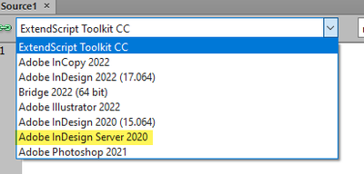

Step 1: started the computer and ESTK
IDS is already on the list
Step 2: Started IDS
Step 3: select IDS as the target, but ESTK says it's not running
Step 4: Click Yes and it takes forever

Jan 28, 2022 Jan 28, 2022
Hi Manan,
Thank you for your answer!
I have no idea how I did it, but I got connected to IDS somehow:
Note: there are two instances. Version 15.064 is the working one. It's strange: I installed 2020.
— Kas

Dear Kas,
You can run only indesignserver 15.064.
-Sumit
