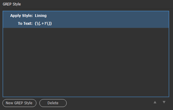

I'm not necessarily a GREP hero, so someone may be able to improve upon this, but you can try Find: (\(.+?\)) Change to: (a Character style with Lining Figures set)
Or, since it's only a formatting change, a GREP Style is applicable.

Okay, so if you add a second GREP style (the one shown above) to that paragraph style it will run after the first and set your dimensions to lining figures.

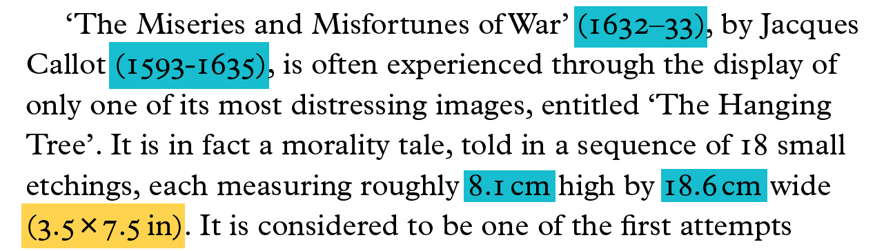

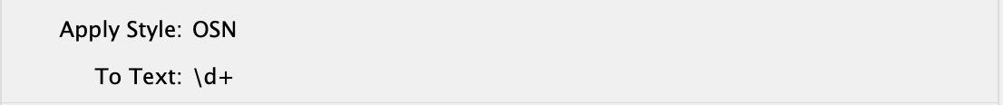

Okay, sorry stephen, I misunderstood, see attached, blue is to keep as OSF and orange is to change. Also attached is the GREP style in question, as I previously mentioned, I can't (although it would be a much better way of doing it) just search for the particular examples, as the old style figures are in a separate expert version of the typeface. This means I need to search for all digits excluding ones preceded or followed by a multiplication symbol. I thought something along the lines of (?<!x~<)\d+\.?\d+(?!~<x) but this didn't work.

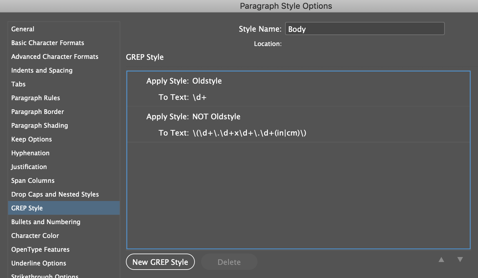

I've built out an example of what I described in my last post. The logic is that I add a GREP Style "Oldstyle" to change all numbers to Proportional Oldstyle. I then apply a second GREP style "NOT Oldstyle" which applies a regular number style to anything it finds in brackets which includes a decimal number, followed by an "x", followed by another decimal number and lastly followed by "in" or "cm". I ran this on your text and it works if I correctly understand what you are trying to achieve
Character Style: Oldstyle
In the OpenType Features section sets the Figure Style to Proportional Oldstyle
Character Style: NOT Oldstyle
In the OpenType Features section sets the Figure Style to Tabular Lining
Paragraph Style: Body
GREP Style #1
\d+ - Any digit, one or more times
GREP Style #2
\(\d+\.\d+x\d+\.\d+(in|cm)\)
\( - Opening bracket
\. - Decimal point
x - An actual letter "x"
\. - Decimal point
(in|cm) - The literal text "in" or "cm"
\) - Closing bracket
If your text contains spaces, just add these to the GREP Style definition...
To find: (3.5×7.5in)
To find: (3.5 × 7.5 in)
\(\d+\.\d+ x \d+\.\d+ (in|cm)\)
