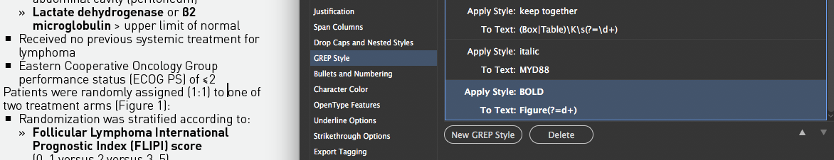

Hi, i am trying to apply my BOLD character style to "Figure 1" in my copy. and i set the code to the below. as in apply bold to any word Figure and whatever number(s) is next to it. but this is not correct, what am i doing wrong?

Community Expert , Nov 05, 2018 Nov 05, 2018
(Table|Box|Figure)\s\d+
You need to put your three variations within parentheses, otherwise it will find just the word Table, just the word Box, or the word Figure followed by a space and one or more digits.
If you always have a space after the word Figure, then all you need is Figure \d+
But keep in mind that if you want your parentheses to also be bold, you will need \(Figure \d+\)
No, your regex is incorrect. What you have written is: apply bold to the word Figure if it is followed by a digit (or more). Try this:
Figure\s\d+
It means the word Figure, followed by one space and one or more digits
Actually it's just "Figure" when followed by one of more plain d's (also without any space). So it'd match "Figured" and "Figureddd" but not "Figure 2" or "Figure2".

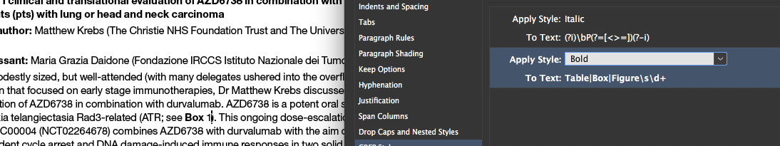

that did it.  so if i want to say to that however to also look for the word "Table" and "box" the code will be:
Table|Box|Figure\s\d+
correct? because "|" means "or"

just tried that last code and "Box" goes bold, but not the number next to it:
Guru ,
BINGO!
