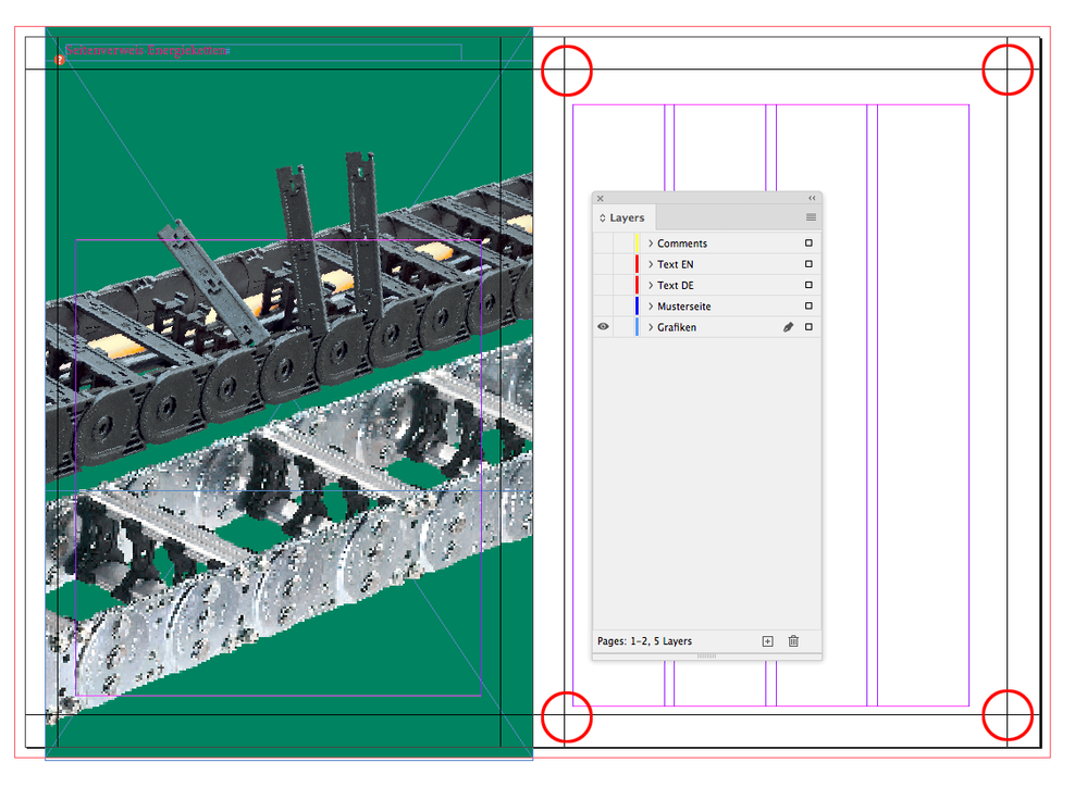

The script is adding page guides, are you sure you don’t have guides hidden—View>Grids & Guides>Show Guides? And your View>Screen Mode is set to Normal?
Aug 26, 2020 Aug 26, 2020
This is what I get with guides showing in Normal mode when I Run

I notice your file is saved with the View>Screen Mode set to Preview, and page guides don’t show in Preview mode. Also there are a lot of page items and the guides get added on the bottom layer. The script could create a top layer for the guides with the color set to black.
Here I’ve hidden your layers with the bottom layer showing so it is easier to see the scripted guides:
