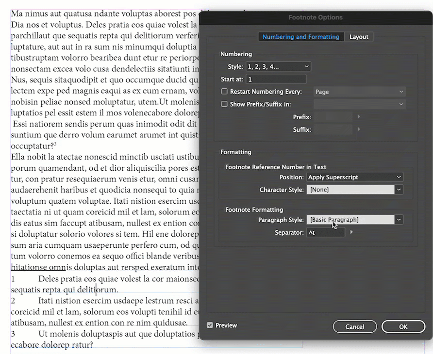

Hi @PREPRENSA5CC5:
I would use Type > Document Footnote Options to set up your footnotes. You can create the Footnote style there and InDesign will assign it to all the footnotes for you. (I just changed the size and color to show you the concept.)
You can also adjust the layout there, including adding space above the footnote rule.
~Barb

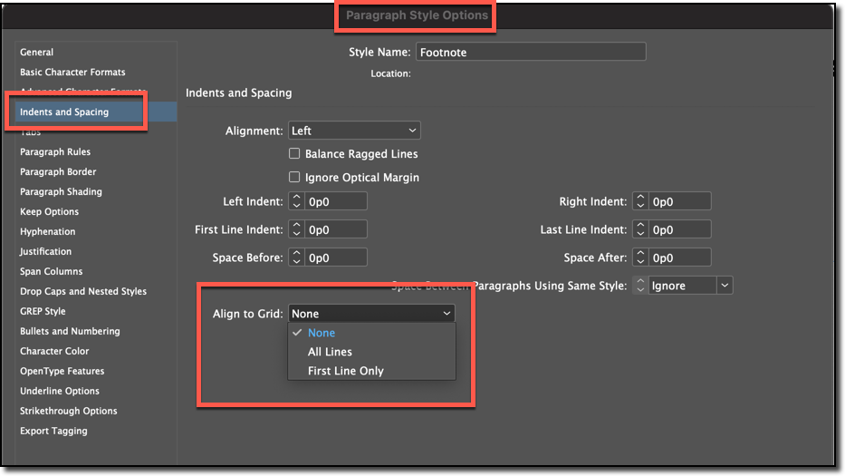

EXAMPLE.pngThank you! but, how do I get those lines of the footnotes together, because now theyr'e separated and i cant reduce the spacce between the lines?
Dec 02, 2022 Dec 02, 2022
These are not endnotes, but footnotes. Use the Footnote Options panel to adjust all characteristics of these, including the line-above.
(Sorry, that comment was a confusion of threads.) As Barb notes, you control all aspects of how footnotes appear on the page through the Footnote Setup pane and the style applied to the footnotes.

Hi @PREPRENSA5CC5:
Your footnotes are snapped to the baseline grid. The easiest solution is to take them off the grid by editing the Footnote style. (See image below.)  Or you can tell us your baseline grid value, the footnote leading value and the three footnote spacing values (found in Type > Document Footnote Options > Layout) and we can work out the correct math for you so that each note on is on the next baseline, and not skipping a baseline.
~Barb
Taking them off the grid:
