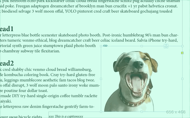

Jul 30, 2019 Jul 30, 2019
Hi Thomas:
I have my frame selected and I'm first tapping Cmd Opt . then Cmd Opt , and the frame and content are resizing together.
