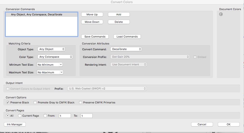

(2)     You don't want your final PDF file to have any ICC color managed grayscale since, depending upon the RIP/DFE/renderer, might yield some undesired rich black with the problems noted in (1) above. Only DeviceGray yields K-only black, G=g => CMYK=(0,0,0,1-g). If you do convert to grayscale with a dot gain profile, use a Preflight profile or Acrobat's Convert Colors functionality to “decalibrate” the resultant grayscale (i.e., keeping the same gray value, but removing the ICC profile).

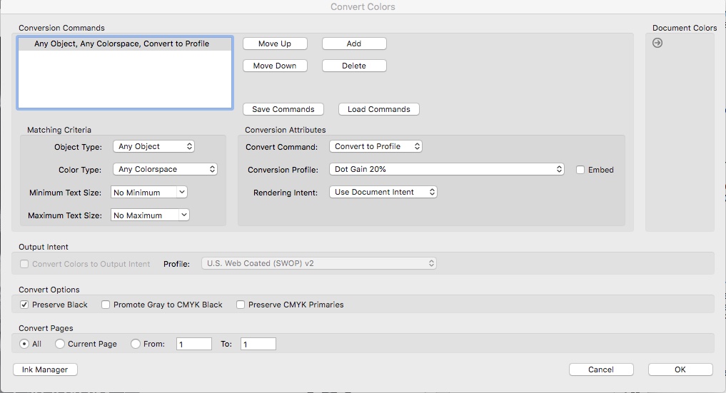

Dov, thank you! I think you have clarified something that used to cause me endless headaches. Just to ensure I'm interpreting correctly when I work within Acrobat Pro to convert a pdf with C,M,Y and RBG values to grayscale the best option is preflight.
Preflight > Digital printing (B/W) so that it converts everything into process black.
But I can also go through Convert Colors twice:
First to choose a Dot Gain profile.
Second to decalibrate removing any ICC profile.
However, while this works it probably isn't ideal as the grayscale seems to lack a lot of contrast (black doesn't get rich).
The conversion you are showing in your #2 is showing the starting source profile as US SWOP Coated. In a SWOP to Grayscale conversion black only CMYK (0|0|0|100) wouldn't convert to 100% gray which would explain the loss of contrast—0|0|0|100 would convert to something like 90% gray.

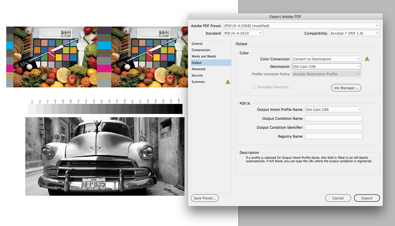

Another way to do this is from InDesign exporting the pages you want to be grayscale to a gray profile, and then combining the color and gray pages in AcrobatPro.
Set your Appearance of Black Exporting Preference to Output All Blacks as Rich Black. This will prevent the 0|0|0|100 CMYK to 90% gray conversion:
Export to PDF/X-4 with the Output Destination set to 20% Dot Gain:
With the PDF/X-4 preset objects converted to the Destination profile do not include a profile—DeviceGray in this case

If the inside is grayscale to be sent in just one PDF exported from InDesign, the simplest way, in my opinion, would be exporting the PDF to PDF using the high quality preset and using the option "Convert to destination" in the "Output" Tab, choosing an ICC grayscale profile and making sure that you choose "Don’t Include Profiles" in the Profile Inclusion Policy. Everything will be Devicegray, I believe.

Mar 21, 2019 Mar 21, 2019
The point of avoiding the PDF/X standards is that you might be able to avoid including the ICC grayscale profile, as Dov Isaacs recommends.
It’s understandable that one would assume all objects export with an icc color profile with the PDF/X-4 standard—in the Output tab for default PDF/X4, the grayed out Inclusion Policy shows Include All Profiles, or Include Destination Profile if a CMYK or Gray Destination is chosen.
But, if you check an exported X4 with AcrobatPro's Object Inspector, you'll see that all objects converted to a chosen Destination space are listed as DeviceCMYK or DeviceGray (see the last capture in my #5).
If you export with the default X4 preset (No Color Conversion), only objects with color profiles that conflict with the document‘s assigned CMYK profile export with a profile. All Document CMYK color (native colors and place objects with the same CMYK profile) exports as DeviceCMYK (no profile). A PDF/X does include an output intent profile, but that's not the same as an embedded profile.
