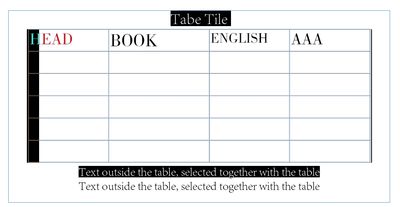

If you have multiple cells selected the following will give you text of the cells
app.selection[0].cells.everyItem().contents
If you have some text selected which is outside the table and have the table selected as well. then the following will get you contents of all the cells in the selected table
app.selection[0].tables.everyItem().cells.everyItem().contents
If the extire frame is selected then the following would work

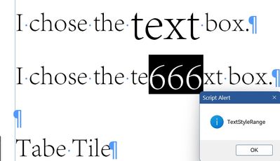

Aug 10, 2025 Aug 10, 2025
HI
The rest basically worked.
But this seems wrong. I only want to change the currently selected "te666xt b", not "chose".
The constructor.name here also seems uncertain. It could be Text, Word, Character, all numbers, or TextStyleRange.
My target audience seems to be wrong.
alert(app.selection[0].constructor.name);
if (app.selection[0].constructor.name == "Text") {
    selWord();
function selWord() {
    app.selection[0].texts[0].appliedParagraphStyle = parStn;
What is TextStyleRange? TextStyleRange? It's not called "number"?

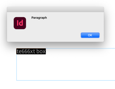

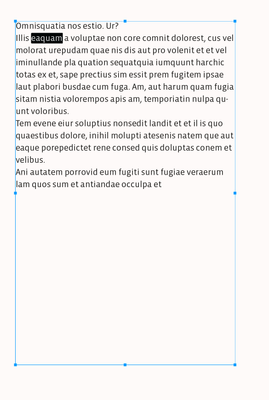

You have more than a word and less than a paragraph selected so its constructor name is Text
The constructor name depends on what is selected:
alert(sp.constructor.name)

You will run into problems if you assume the selection includes a table. If I wrap the selection in a try statement :
try {
    alert(app.selection[0].tables.everyItem().cells.everyItem().texts[0])
}catch(e) {
    alert(e)
