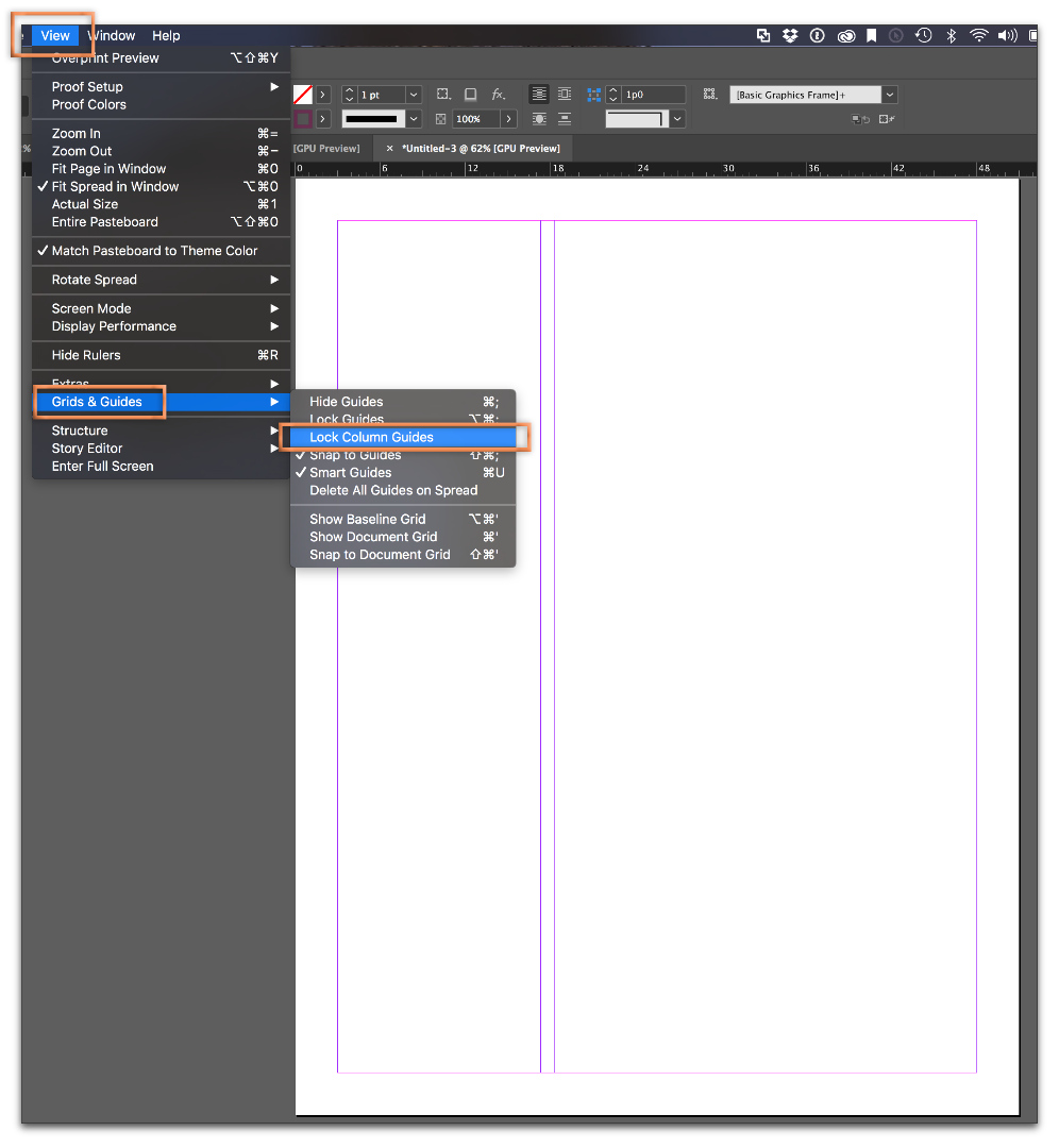

View > Grids & Guides > and click on Lock Column Guides to uncheck it. Now you can drag the columns to asymmetrical measures. Don't forget to put a gutter between Column Guides. (Layout > Margins and Columns ...)

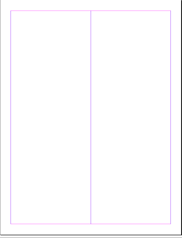

Hey Morty: Let's step back for a moment. Are you clear how to define columns?
  1. Via File > New
  2. On the master pages with Layout > Margins and Columns
  3. On an individual body page with Layout > Margins and Columns
Designers are trained to design on a grid. Columns represent the grid, and they draw frames on top. For more info on the concept, see:
https://designschool.canva.com/blog/grid-design/
Alternatively, you can simply move the exisiting guides anywhere you like. There are three steps:
  1. Unlock the column guides
  2. Select the Move tool Selection tool!
  3. Place the Move tool Selection tool! right on a purple guide (note the confirmation of placement—it's the small black rectangle under the cursor when you are in the right location to move them.)

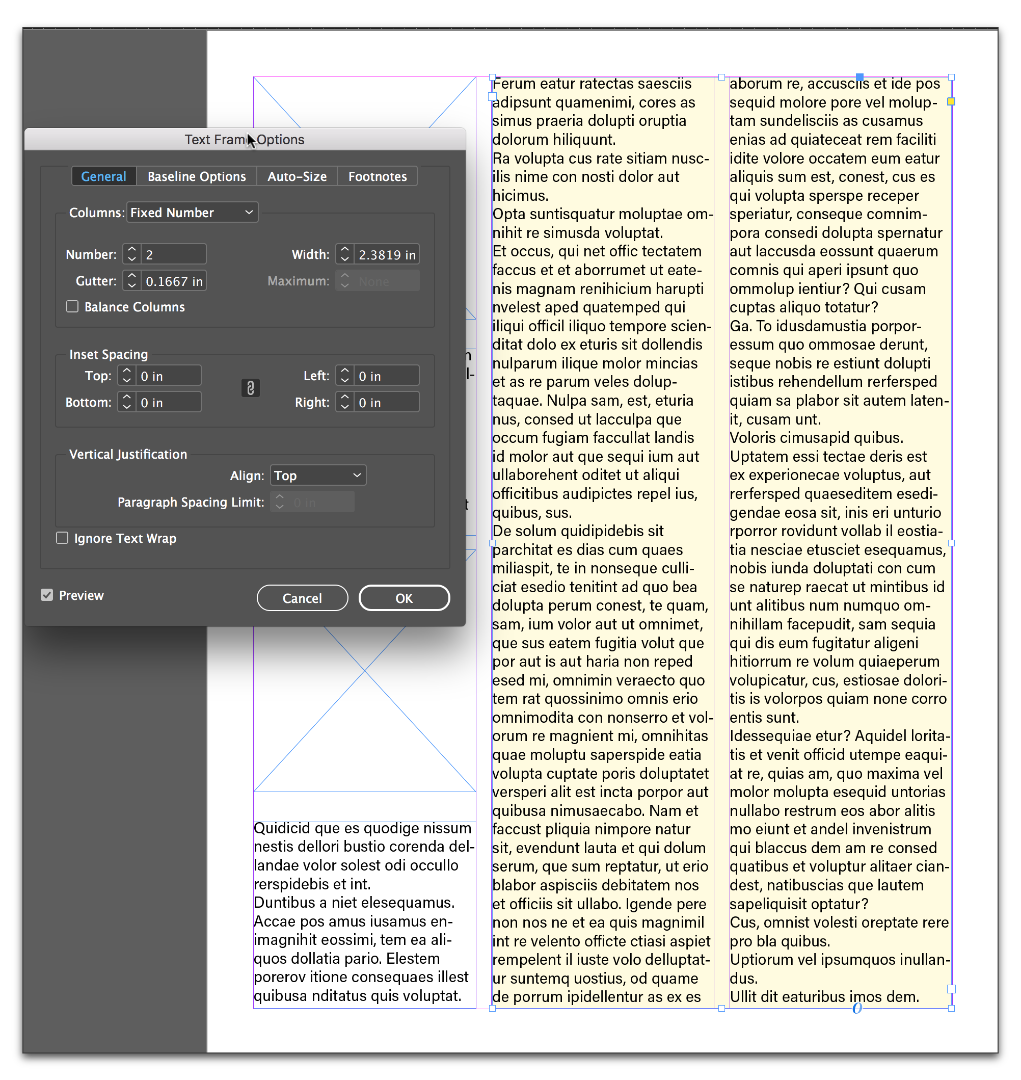

  1. First set up the columns
  2. Then draw frames over the columns
  3. Optionally, you can set a frame to be one or more columns with Object > Text Frame Properties. (See yellow frame below.)
If text is moving from one frame to another, the frames are threaded (connected). Using the page you are trying to emulate as a guide, you don't need threaded text frames, nor do you need to divide the right text frame into multiple columns.

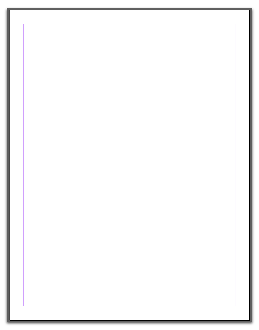

I'm not following you here, Morty.
1.) You appear to have set up columns on the page as 2 columns, no gutter, so they are not effectively working for you as a grid to divide the page into thirds.
2.) Text boxes and text frames are the same thing. Yes, they are above your pink top margin, and yes, if you move them down, they will move down. The contents will move down with them.
create text boxes in them, BUT could only start the text boxes a bit about the text frames, and when I used the pointer to move them down, the text frames themselves were also moved down.
3.) I can't tell from the screen shot why you can't delete text in the left frame.
  1. Is the frame on the body page?
  2. Is the frame locked?
Let's just simplify this. To create the desired page, create a new blank, 1 column page. Draw text frames where you want to add text, and graphics frames where you want to add images. (No idea why my screen shots are hiding the right lines, but they are there on my screen.)
I can't tell if the disconnect is on understanding how the margins and columns work (pink and purple lines on the page), or how frames (text, graphic and unassigned) work.
The community forums are a great place to get a question answered, but they are not meant to substitute for a training class. I'm just about to start my Intro to InDesign class, and we will have covered all this and more by lunch. You have access to amazing trainers in New York. Less expensive alternatives include working through Adobe InDesign CC 2017 Classroom in a Book, or watching "InDesign CC 2017 Essential Training" with David Blatner on Lynda.com. (Here's a link for 10 free days: Online Video Tutorials at lynda.com • lynda.com). These are three great ways to learn InDesign, and then pop in and ask us anytime you get stuck. We'll be here for you.

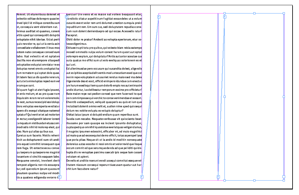

Also, if you decide to make columns from individual text frames and you expect text to flow into the columns, they have to be threaded:
Thread text among frames in Adobe InDesign

Just in case it isn't clear from the other posts: the Columns and Margins setup in the New Document dialog, or Margins and Columns under the Layout menu (which can be applied to pages of an existing document), only affect the page guides and not existing text frames, or text frames you make.
So here I'm changing the margin and column guides for the selected pages:
If I want to affect the text frame itself I have to choose Object>Text Frame Options:
