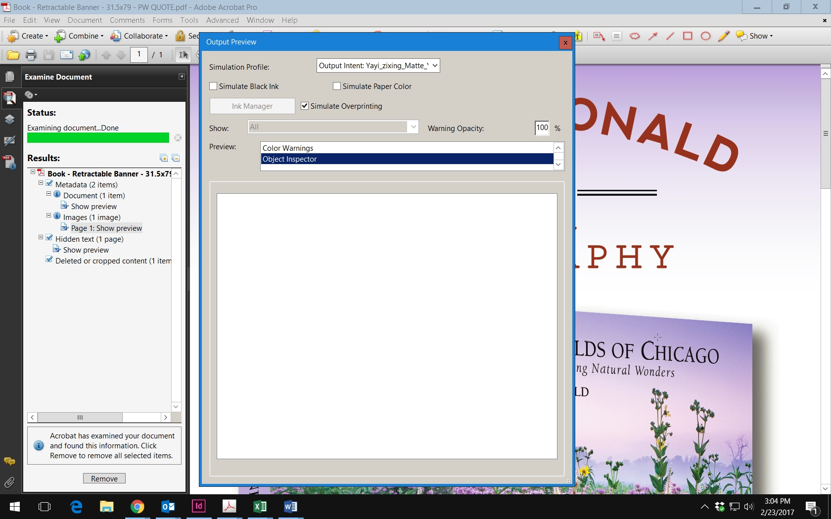

Nothing happens when I click on the Object Inspector, just a white box below. See here:
Feb 23, 2017 Feb 23, 2017
You have to click on the page item object, sometimes more than once to hit it.

Okay, it takes a while to fill in the box. I see it now. That's odd. It still doesn't tell me if it's PDF/x3 or x4, though.
Object Inspector only gives you information about the page items you click on. You can use Preflight to check if a PDF passes an X standard.
I can see from your capture there is an Output Intent, which indicates you exported to PDF/X. Without inspecting the page objects I'm guessing all of the color is DeviceCMYK which means there is no profile. If you really want to send profiled CMYK that conflicts with the printer's output profile, you can't export using a PDF/X preset. You'll have to set the Standard to None and Include All Profiles.
