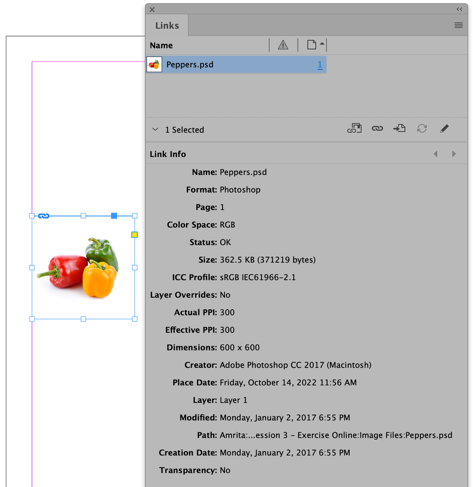

Perhaps I'm misunderstanding your question, but usually placed objects need to be scaled to be at a smaller size than their original size:
Here is an image placed (File > Place) at its original size by clicking to place it.
The Links panel shows it is the same size as the original.
I use the Scale fields on the Control panel to select 150% scaling:
The result is that its Effective Resolution has changed and made it larger:
Steve Werner
October 14, 2022
In that example, I scaled it larger. To make it smaller I'd use the Scale field to choose a smaller percentage like 50% and the image sould get smaller. (You can also hold down modifier keys Cmd+Shift or Ctrl+Shift to scale visually.)
