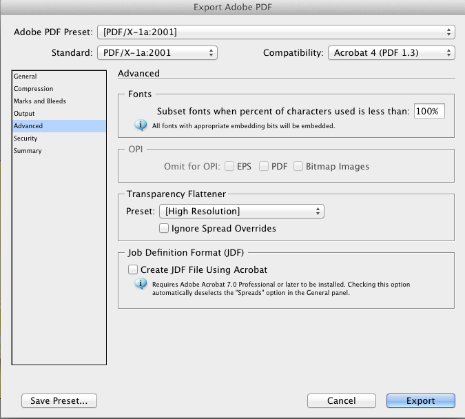

Press Quality PDF preset does not flatten transparency. That's probably what the printer is having problems with.
Choose PDF/X-1a instead. On the Advanced panel be sure to choose a High Quality Flattener Preset. That preset will flatten transpraency.
New Here ,
May 03, 2012 May 03, 2012
I just did everything you said and unfortunately, it actually did the exact same thing as if I chose Press Quality.
Still confused.

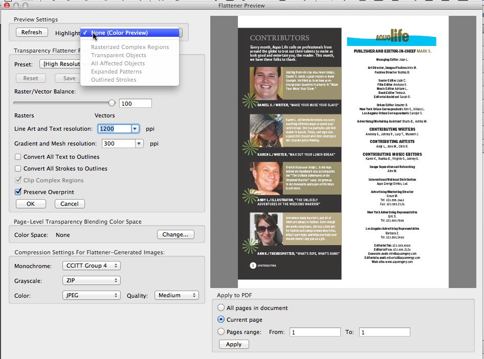

What version of Acrobat are you using? I'll tell you how you can check the flattening in the PDF file. (It's different from Acrobat 9 and Acrobat X).

In Acrobat X, you need to open the Print Production panel under the Tools on the right. It's not showing by default so you need to choose Print Production from the menu at the upper right.
In the Print Production panel, click on Flattener Preview, and you'll see a dialog box like this. Click on the Highlight menu at the top. If there is no transparency, it will show gray as below.
When you open the Highlight menu, if there is transparency, it will look like this:
When you select Transparent Objects, they will show highlighted in red like this:
