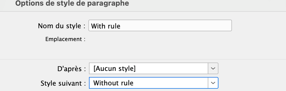

If you don't use a table, make 2 different paragraph styles, one with a rule, another without and use the “next style feature”
Capture d’écran 2023-01-20 à 19.03.41.pngCapture d’écran 2023-01-20 à 19.06.34.png

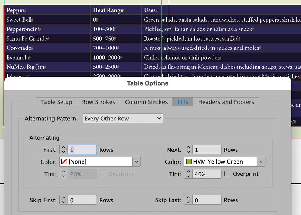

Jan 20, 2023 Jan 20, 2023
Here's an example of how alternative row colors could look in a table:
If each comment contains only one paragraph, you could set up your two styles as Next Style to each other. Then select all the text and choose Apply [stylename] then Next Style. This will cycle the styles down through all of the text.
