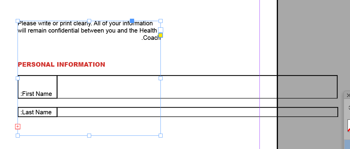

either way... when I insert a word doc... the text flows the wrong way. I have changed all settings I can think of in character, in paragraph, in all places I can think of. The flow is as per screen shot from right to left and I can change it of course but seems wrong that this is the case. help... any ideas?

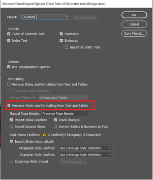

Sorry about the delay. While placing the Word file, please select "Show Import Options" and make sure "Preserve Styles and Formatting from Text and Tables" is selected.
Let us know if this helps or if you have any further questions.

thank you.. I had tried this and it still didn't work.
If I copy from Word into Indesign it works but I of course will lose any italics etc if I do this.
In the end I have disabled ME version, and had to go back to normal version which is a bit of a pain

2/ see attached screen shot.  If I place text it comes in with the right to left instead of left to right. I have to go into the text and fix every time I place any text... help!
