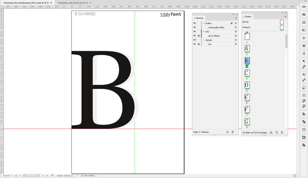

Hi Anya,
the following is working:
If your font license allows, create your own font without side-bearings by using a script like IndyFont created by Jongware and Marc Autret. When done use optical kerning and a vast amount of tracking to typeset your text.
Successfully tested that with a font that has a SIL OPEN FONT LICENSE Version 1.1.
In my case I used the Heuristica Regular that is similar to Adobe Utopia Regular.
Some screenshots below, from the construction process with the InDesign document the IndyFont script provides, where I used the original glyphs converted to outlines in layer Outline, but moved them to the left and also changed the position of the green guide that indicates the position of the right side bearing. The original position of the glyphs can be seen in gray in the non-printing Sample layer:
Usage of that very special font; kerning is set to "Optical" and tracking value is set to 50:
Note: I did only do the glyphs ABCDEFG to test this.
Also note: The above sample is just a proof of concept and requires a lot of effort for serious implementation.
Read about IndyFont and the process of creating fonts solely with InDesign here:
https://www.indiscripts.com/category/projects/IndyFont

Anya said: "Wow that is really cool. Thanks."
Well, it's just a proof of concept.
Note: I did not test anything else, especially not, if InDesign's optical kerning does its job right in this situation. A minimized solution using this idea would be to create a font that has all glyphs from A-Z and a-z where only the first character in a paragraph is substituted with a GREP Style through the applied paragraph style. This would work for situations where every paragraph is only one line of text. A headline perhaps, followed by a subhead. All other text will be set with the original font.
Below the comparison of my special Heuristica Regular without side bearings and the original one.
I used metric kerning and no tracking with the original Heuristica:
Hm. The original Heuristica used in the right text frame needs more love with built in kerning values. InDesign's optical kerning will do a better job, but still needs some tweaking as you can see with the "DE" combination in the left text frame where I used my special font created with IndyFont…
