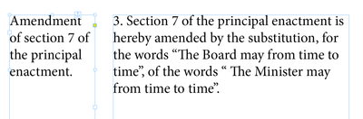

Anchor the margin note text panel to the first line of the main document text paragraph.

Hi!
What you need to play is really simple if you know how to do it! …
You just need to write the "sidenote" para [with the right para style] below the para concerned.
After that, 1 click: all the "sidenote" paras will been "moved" in an anchored text frame!
… Like in this video made 4 years ago for a client [the text is here just copied-moved but it could be cut-moved too]:
