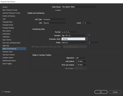

  • Currently at the start of each chapter is a text variable for the chapter number, is it possible to also create one for the subchapters? This would be helpful incase chapters are rearranged again
  • I have a figures reference setup which is keyed to when everything was its own individual chapter number.
Currently they appear as 'Fig 0#-###:' however the subchapters continue as if were chapters, when I would like them to appear as 'Fig 0#.#-###' .What is the best way to enable that the subchapter indd. files are referenced properly?

In an InDesign book (.indb file) you can't designate sub-chapters.
I would handle that via the paragraph style numbering. Set up two paragraph styles: chapter numbers (which are already in place) and the sub-chapter numbers, and then assign them to the appropriate chapters. If the book gets reorganized, just open the chapters and re-assign the first paragraph of those impacted. It won't take more than few minutes—you just have to remember to do it.
