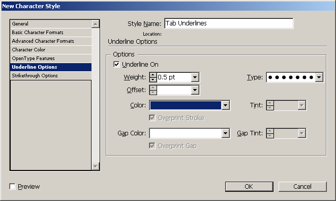

The indicated leader in the screen grab looks more like underscore characters than dots used in the leader field, but here's an alternative method that I use: Define a custom underline using a dotted or dashed stroke and apply it to the tab as a character style (can be done as a nested style). An advantage to this method is it can be used easily with Right-indent tabs that keep the text aligned to the right edge even if you change the column width, regular tab leaders cannot.

But that requires an extra tab, which might be a problem in some text. Plus, with the underline you have more control over simple dots or dashes than you can get using periods or underscores. I often use the Japanese dots stroke style, for example, with it's smaller dots and set a light stroke weight to make the leader less obtrusive. You could also use it to change the color of the leader if you wish.
Underlined tabs are certainly not the only way to go -- it's a matter of personal choice -- but something to be considered if you want more control.

Thank you all for your comments. i did it within tab leader, but there is less control over it. As it is mentioned by Peter Spier, there is other way how to do it with character style etc. But i cannot do it, i do not know how... I do understand character style but i cannot set it up right. Could you please describe this method please more detail? Thank you!

Jul 31, 2016 Jul 31, 2016
Other options in the other sections of the dialog should be left blank. Choose the underline style that you prefer from the dropdown and adjust the offset to your liking.

Thank you for your print screen, could you describe way how to reach the visual style as it is on the attached picture on the top of this topic with this method please?

As I said, from the image in your first post it looks like an underscore used for the leader (is that what you did?). If so, then choose a dashed style from the dropdown instead of dots. You may have to define a new stroke style to get exactly the look you want.
