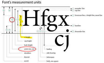

Let me go back to the disscution: i've got half-way solution now, i got a script that gives back dimentions on click over any element, that include text.
This is how it work: (screencast) https://www.youtube.com/watch?v=g-UEZM-DtEI
Now the only thing i need to do is to move the text upwards inside the text rectangular (don't know what is its official name) so  i could measure the body of the small letters (not caps) without the "invades" of the text (like the top of the "d")
the Q is a good example of a letter the spans out of the rectangle.
The area i want to measure is ranged between those 2 purple lines.
i looked over "charecter" and "paragrapgh" but didn't find any way to do it.
any ideas?
Jun 22, 2020 Jun 22, 2020
So you want the x-Height (lowercase) dimension, and not the Cap Height?
Participant ,
Exactly!

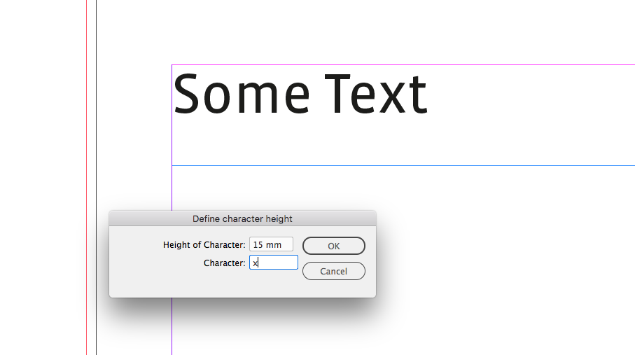

Checkout the script Uwe posted, I think it does what you want. Select some text, enter the target outpuut dimension in the Height field, and a lowercase x in the Character field:
The resized text:
Here the direct link to Gerald's script SetVisualCharSize.jsx :
https://www.cuppascript.com/wp-content/uploads/2019/02/SetVisualCharSize.zip
Just tested it with InDesign 2020. It's still working!

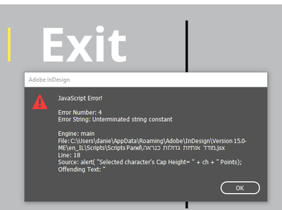

when i play the script i get this message:
Sorry, there was a missing quote mark at the end of the last line. Should be this:
var doc = app.documents[0];
var docViewPrefs = doc.viewPreferences.properties;
doc.viewPreferences.horizontalMeasurementUnits = MeasurementUnits.POINTS;
doc.viewPreferences.verticalMeasurementUnits = MeasurementUnits.POINTS;
var sel = doc.selection[0];
app.copy();
var textFrame = doc.textFrames.add({geometricBounds: [0,0,"100mm","100mm"], textFramePreferences: {firstBaselineOffset: FirstBaseline.CAP_HEIGHT, insetSpacing: 0, minimumFirstBaselineOffset: 0, verticalJustification: VerticalJustification.TOP_ALIGN}});
app.select([textFrame.parentStory.insertionPoints[0]])
app.paste();
var ch = textFrame.texts[0].insertionPoints[0].baseline;
textFrame.remove();
doc.viewPreferences.properties = docViewPrefs;
alert( "Selected character’s Cap Height= " + ch + " Points");
